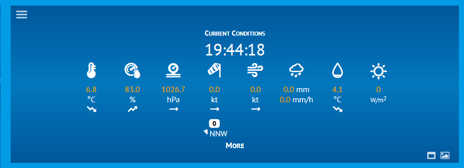

Post by Jolumarali » Wed Feb 09, 2022 7:59 am
Hello
Would a meteotemplate user have an idea to change the colors of the data display (see image) on the Block current
thank you

Post by davidefa » Wed Feb 09, 2022 6:58 pm
I've added an option ( it is the sixth ) to define sensor values colour ( time, icons, unit of measure and trends unchanged ). Don't know if this is the effect you are referring.
current_24.2.zip
(355.41 KiB) Downloaded 1073 times

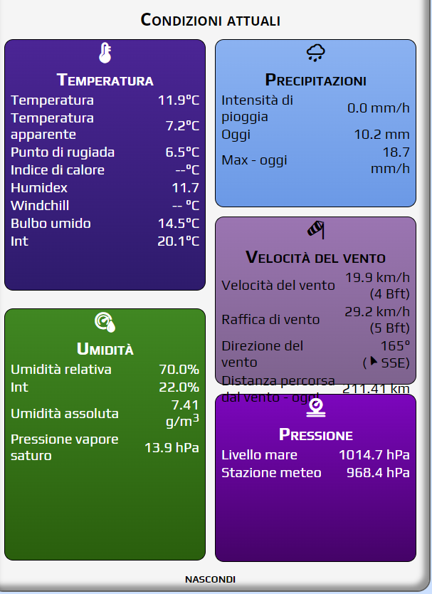

I upgraded to version 24.2 of the Current Conditions block.
By extending the block, the wind speed data is superimposed on the pressure data.
Is it possible to fix the bug?
2022-02-15 14_30_52-MeteoFabro.png (84.42 KiB) Viewed 65074 times
Re: Block Current
Post by davidefa » Tue Feb 15, 2022 10:16 pm
ver 24.3
Resized detail blocks ( only when 5 blocks shown )
current_24.3.zip
(355.44 KiB) Downloaded 1647 times

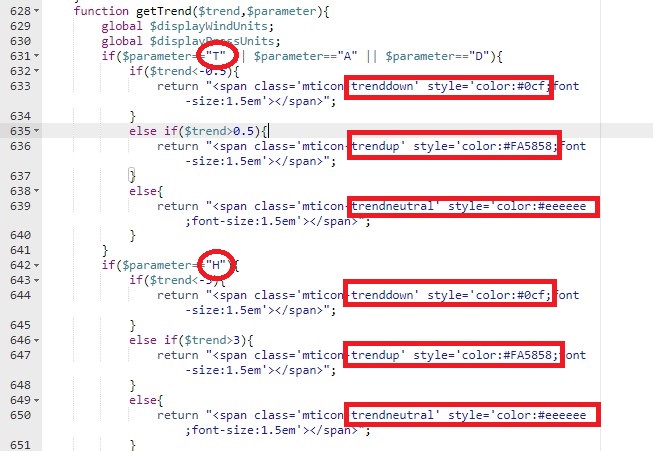

Re: Block Current
Post by meteoesine » Sat May 07, 2022 4:54 pm
on updater.php in current block folder
around line 630 for any parameter (T,H,P,.....) add style='color:xxxx; as in the enclosed pictures
enjoy
