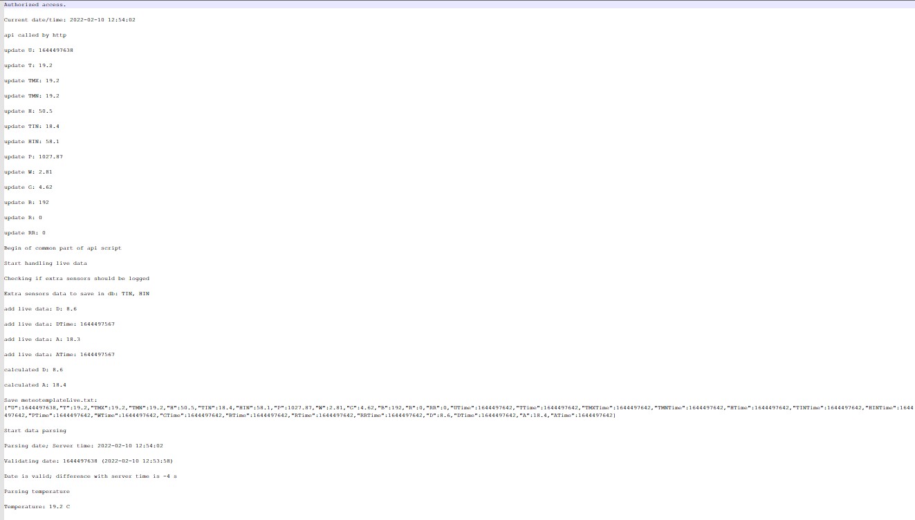

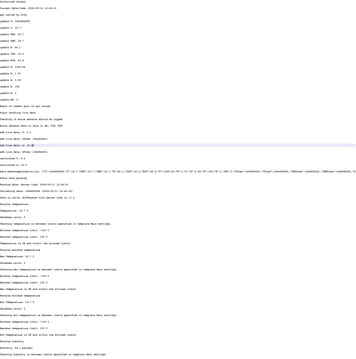

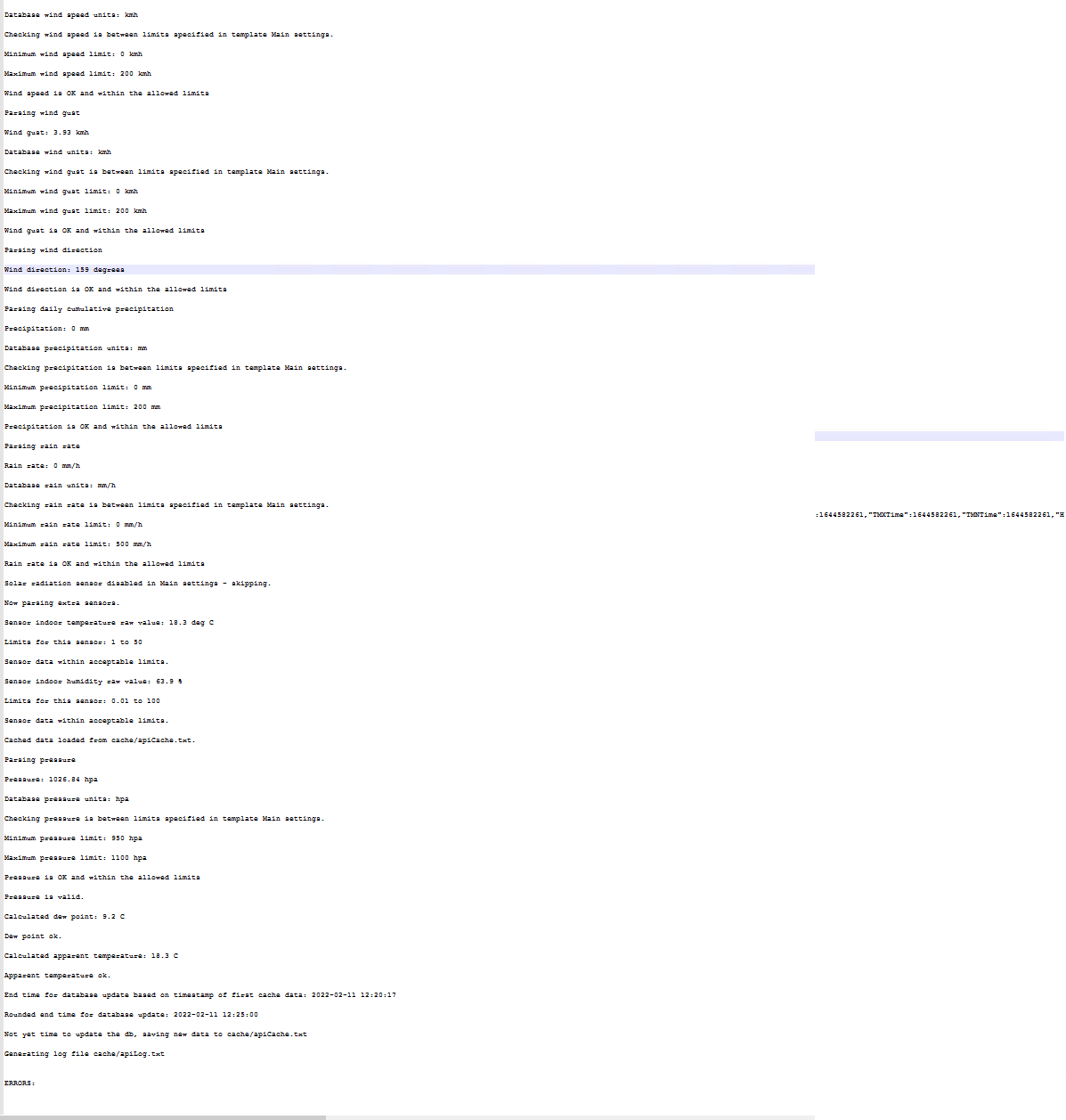

I send meteotemplateLive.txt, cache/apiCache.txt and cacheapiLog.txt
Thanks in advance!
Api updates doesn't update database. meteotemplateLive.txt is ok
- meteotemplateLive.jpg (46.21 KiB) Viewed 6443 times
- apiLog.jpg (68.71 KiB) Viewed 6443 times
- apiCache.jpg (51.72 KiB) Viewed 6443 times

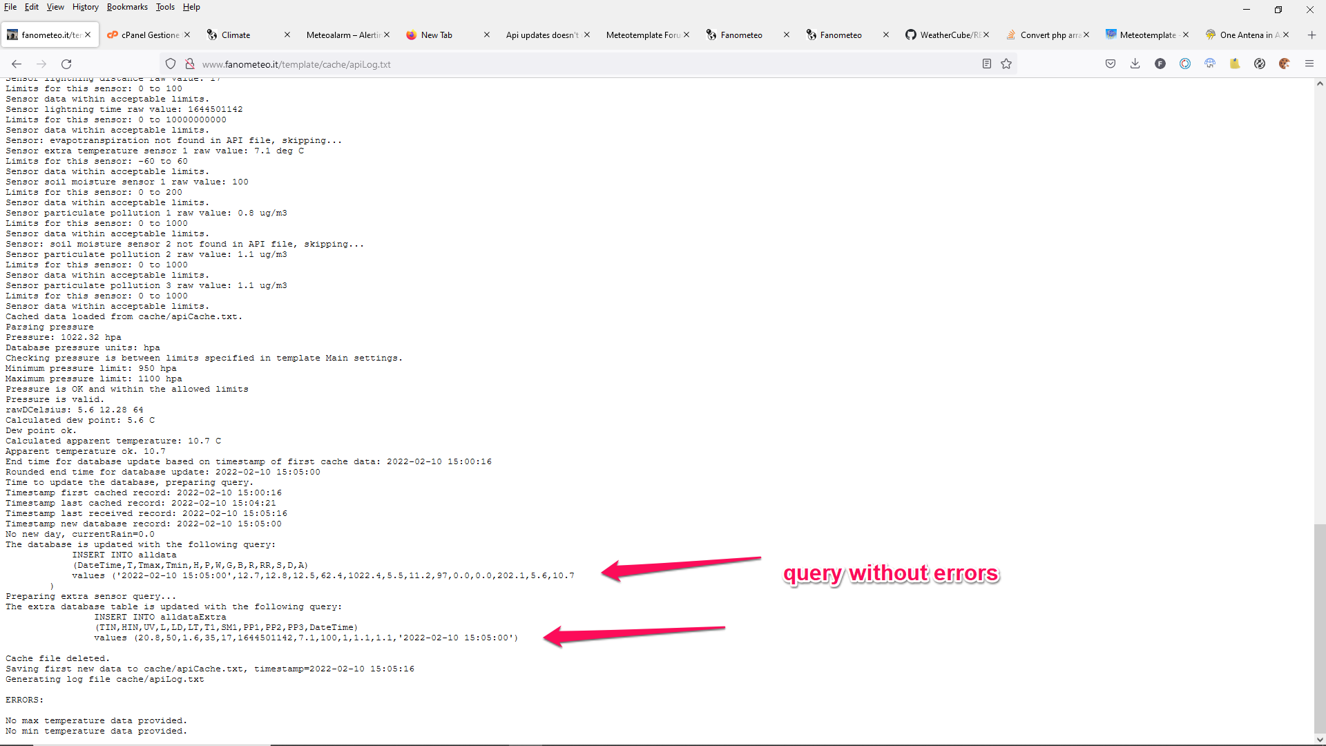

First of all check your cache/apiLog.txt and wait for the datadase update interval ( every 5 minutes ) near end of the file you should see the database query and the query result ( or error if any ).

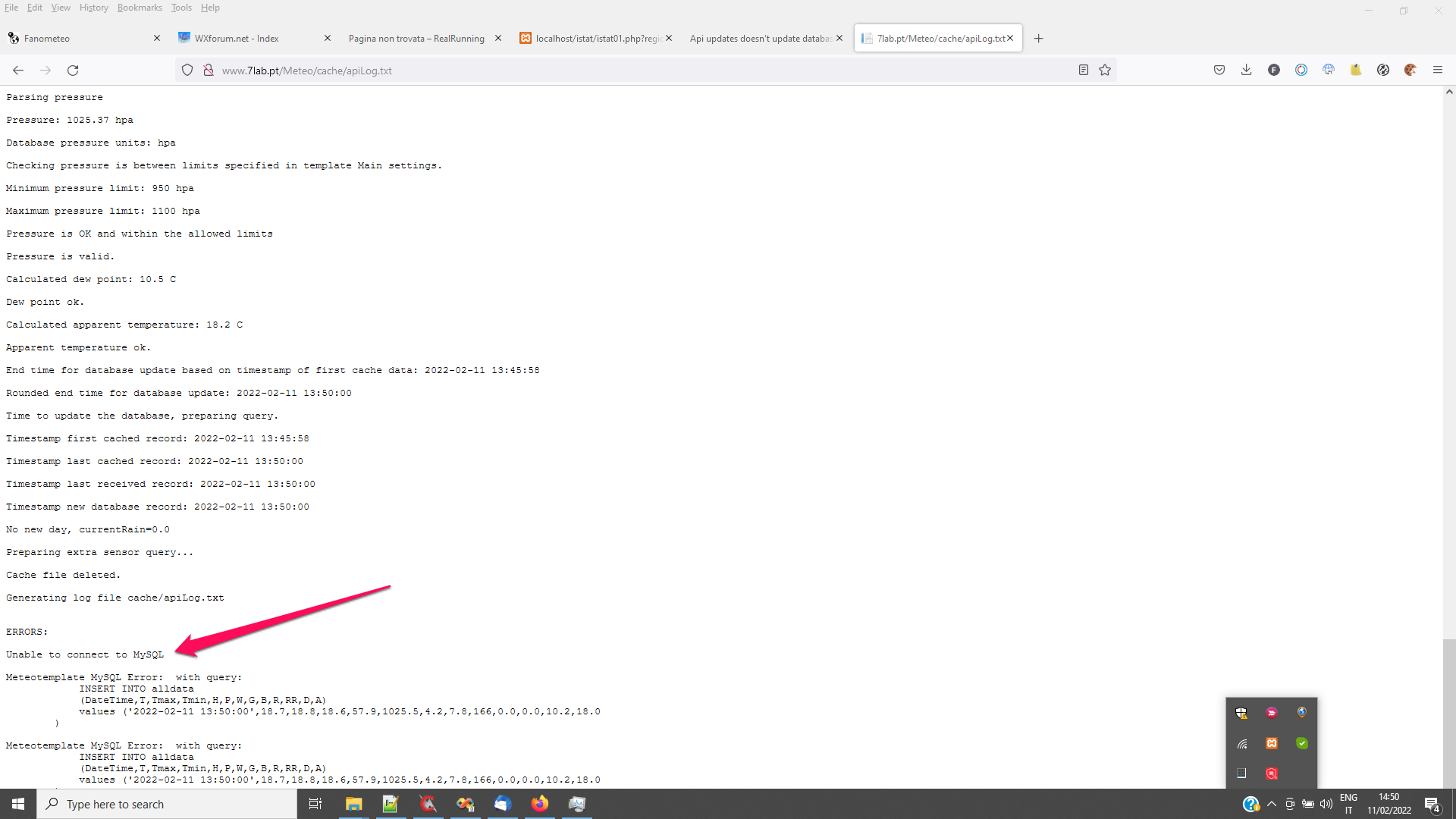

My apiLog.txt has a different format from yours.
I attach all my cache/apiLog.txt. Two images.
Can I define another level of logging?
Thanks!
My site URL
http://www.7lab.pt/Meteo/indexDesktop.php
Thanks!
- apiLog.txt Part1_2.png (47.59 KiB) Viewed 6432 times
- apiLog.txt Part2_2.png (53.58 KiB) Viewed 6432 times

The format is the same ( I have only removed the blank lines... and a few other changes ).
Every 5 minutes api.php saves data to the database ( you have to wait this 'event' ):
- script does not connect to database
- in the main setup of meteotemplate, check the 4 parameters of database: host address, user, password, database name

It is not easy to catch the DB errors on apiLog.txt, because que apiLog.txt is deleted and created each time I use API. Since Api only write to DB one time each 5 minutes, and I update my site each minute, the possibility to see DB error is low.
I changed Api.php the DB interval for update for 60:
// Check db update / update db
$dbInterval = 300;
Than I start to have the possibility to see DB Error all the time and it was easier correct the problems.
