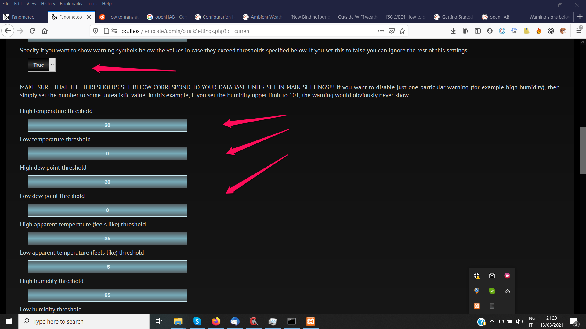

Post by davidefa » Sat Mar 13, 2021 8:27 pm
In the current block setup set the warning threshold ( or disable the warnings )

Post by staze » Mon Apr 18, 2022 2:28 am
Thank you sir! This worked perfectly. Sorry for huge delay in responding!
