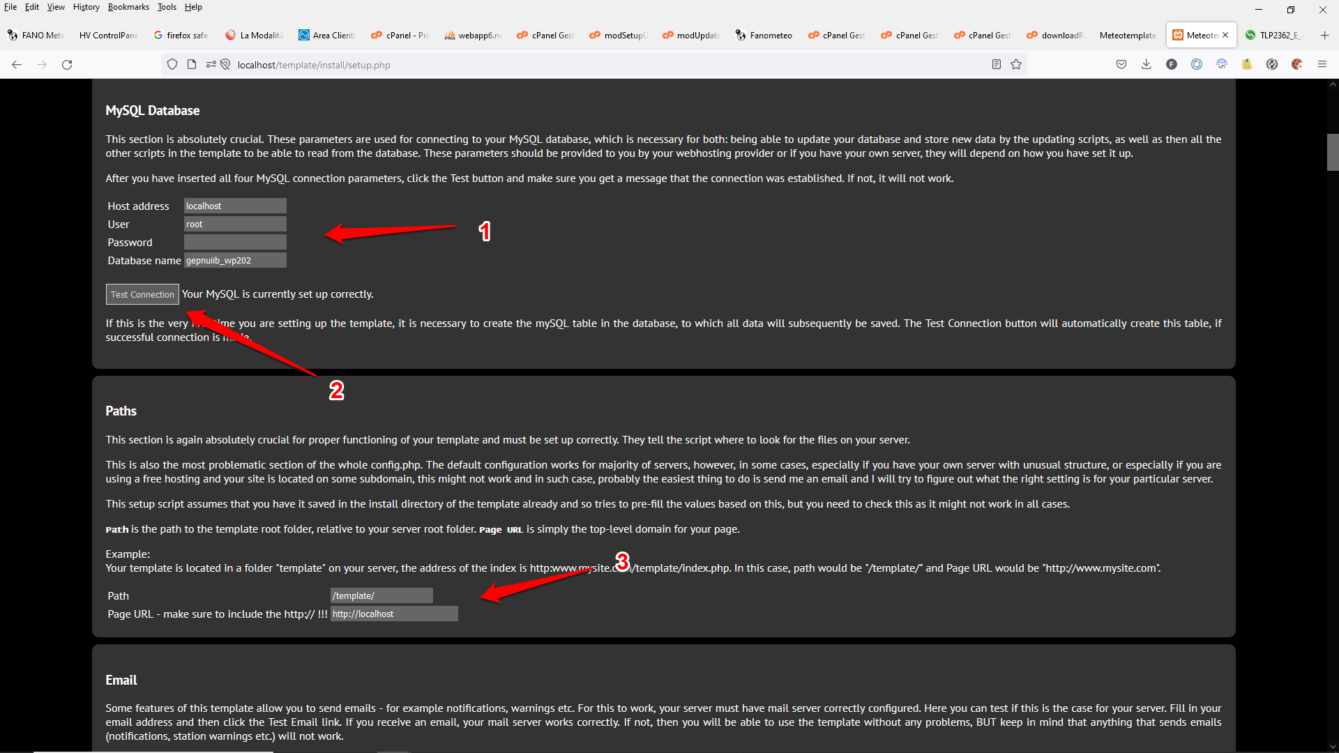

- did you complete the setup process?
0) via phpmyadmin create a database and an user
a) click the check server button
b) set the admin and update passwords
c) set the mysql section ( with the data from point 0), click the Test connection button ( as this will create the necessary tables in the database )
d) set the path section ( I think should be similar to that in the image )
If you completed correctly the above steps you should be able to access the main page ( quite empty dough ) and the control panel

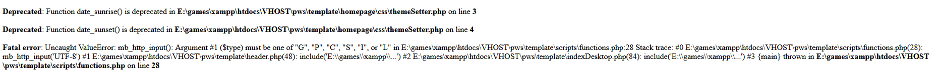

Deprecated: Function date_sunrise() is deprecated in D:\games\xampp\htdocs\VHOST\pws\template\homepage\css\themeSetter.php on line 3
Deprecated: Function date_sunset() is deprecated in D:\games\xampp\htdocs\VHOST\pws\template\homepage\css\themeSetter.php on line 4
Warning: file_get_contents(D:\games\xampp\htdocs\VHOST\pws\template/lang/<br /> <b>Warning</b>: Undefined variable $lang in <b>D:\games\xampp\htdocs\VHOST\pws\template\install\setup.php</b> on line <b>1309</b><br /> .php): Failed to open stream: No such file or directory in D:\games\xampp\htdocs\VHOST\pws\template\header.php on line 30
This i got fixed by setting language forced to US.
Fatal error: Uncaught ValueError: mb_http_input(): Argument #1 ($type) must be one of "G", "P", "C", "S", "I", or "L" in D:\games\xampp\htdocs\VHOST\pws\template\scripts\functions.php:28 Stack trace: #0 D:\games\xampp\htdocs\VHOST\pws\template\scripts\functions.php(28): mb_http_input('UTF-8') #1 D:\games\xampp\htdocs\VHOST\pws\template\header.php(48): include('D:\\games\\xampp\\...') #2 D:\games\xampp\htdocs\VHOST\pws\template\indexDesktop.php(84): include('D:\\games\\xampp\\...') #3 {main} thrown in D:\games\xampp\htdocs\VHOST\pws\template\scripts\functions.php on line 28

Ok I can access your site.
As you reported, the main page stops with an error in scripts/functions.php on line 28.
You may substitute this file with the attached one ( I slightly modded it for compatibility with php 8.0 ).
For example line 28 is commented out as it is not needed/not correctly used.
As you say, if the DocumentRoot of your site is d:/games/xampp/htdocs/VHOST/pws/template the 'path' setting in meteotemplate should be / ( or /template/ ; - ).

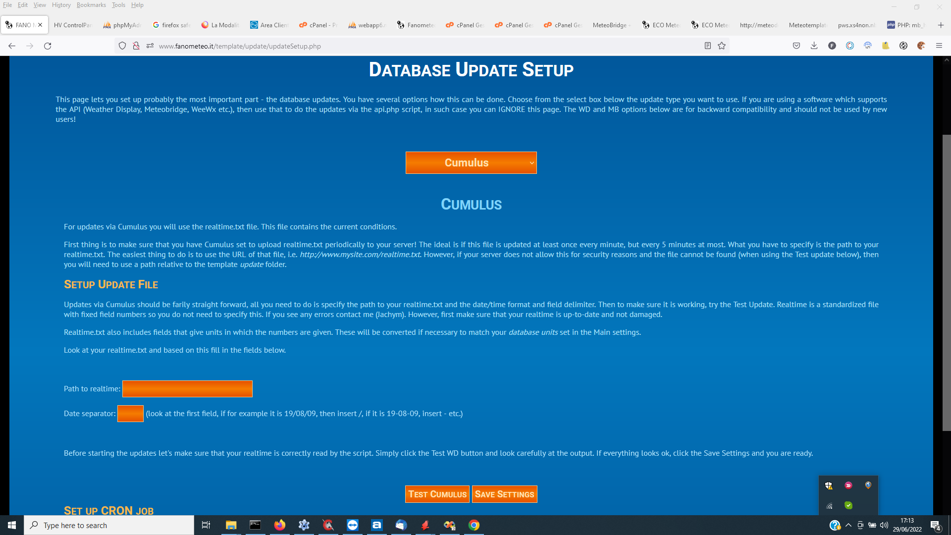

For the realtime.txt file you can place anywhere ( in the document root directory for example ).
In the meteotemplate control panel -> 'database update' you have to set the correct path.
