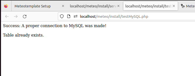

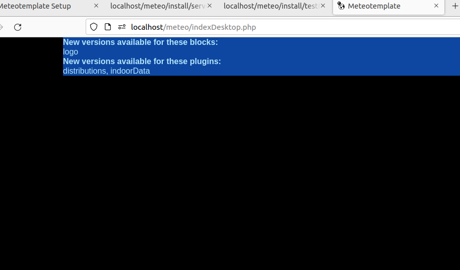

Tried to setup an virtual environment for testing. OS is Ubuntu 22.04, after installing Apache, PHP and mysql the system is finally ready for operation. To find to correct versions was a bit messing around, but now it seems running (more or less).
What I did: downloaded a complete package with meteotemplate_v18, the php8_1.0.zip and the php8_1.1.zip.
Extract all archives, copied first the files from PHP8_1.0 to the referring locations, then the files from PHP8_1.1.
Finally transferred all to my web directory.
Starting the setup seems to be fine: Config file was created, but when accessing the web site, I got only a blank screen and an update notice???
Yes, there is no real data in DB, is is just an empty dummy DB, but I expected at least that blocks, header and footer is visible.
But there is not even an error message, just blank!?
I did the installation now multiple times, always with same result. Anyone an idea?
At my real web server (hosted by Strato) running with PHP 8.0 is working without issues (as noticed until today).
Edit Jan., 22th 2023: To still curiousity I did the same installation (VM) with PHP 7.4, runs exactly as expected. No idea, why PHP 8.0 behaves in this strange way.
BTW the real website is now running with PHP 8.1.14, see my post above.

Re: meteotemplate php 8.0/8.1
Been following this post and have updated all the files as mentioned above, only thing not working for me is the layout looks a mess - not sure if its a browser issue or do I need to run the install again after the file uploads?
- Screenshot 2023-02-10 at 1.19.47 PM.png (352.97 KiB) Viewed 42194 times
I see you have http to https redirection enabled.
Check in the install/setup.php that your pageUrl ( point 1 ) includes https://
