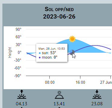

just opened my page for the first time today and it shows yesterday afternoon...
- 2023-06-28 11_42_43-Bergen Lynradar.png (16.42 KiB) Viewed 12297 times

The block shows me today, but the sun/moon icons remains all day at about 08:19.
So not sure, what is bad behaviour of block and what is slow connection.

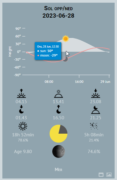

can confirm a ctrl-F5 does not help in the browser, ctrl-F5 after deleting the template\cache folder works.
I see now that also the cloudheight and airquality block have the same problem ...
Now it is correct adter deleting cache:
- 2023-06-28 12_27_46-Bergen Lynradar.png (30.7 KiB) Viewed 12294 times

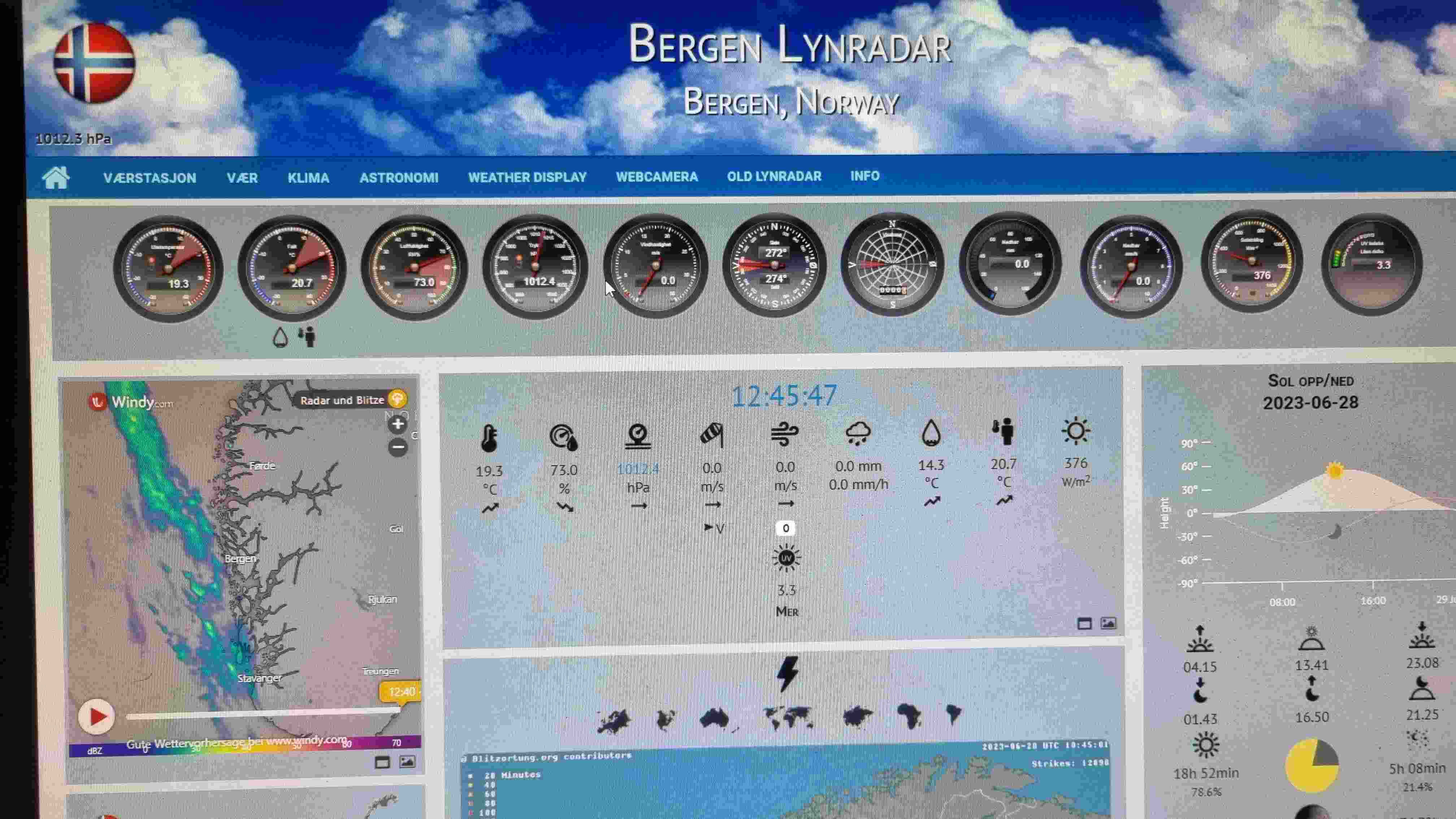

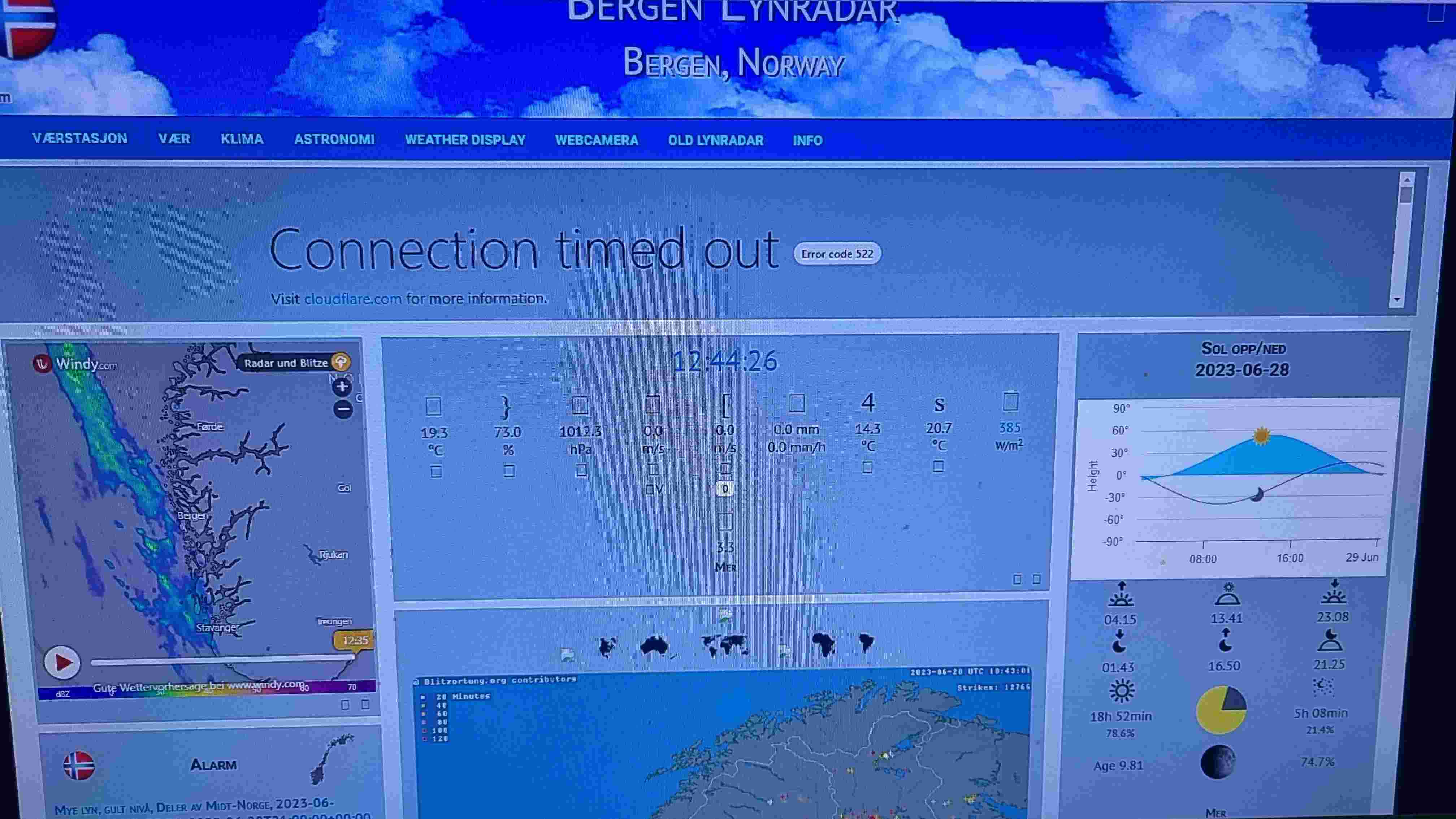

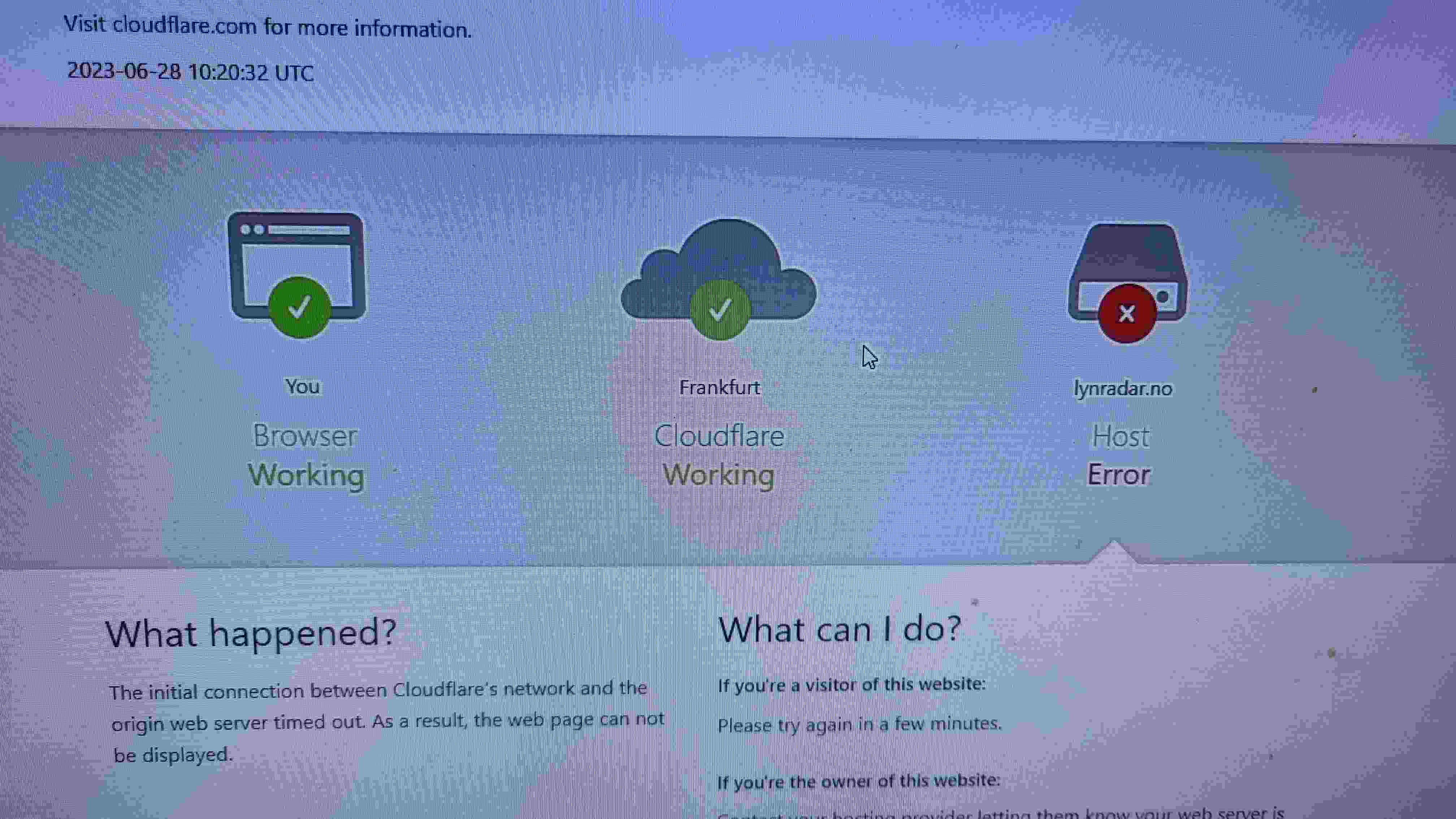

At least once the riset shows the actual time, even if site is not fully loaded.
Screenshots attached from several trials to (re)load the page.

thank you that was good information, looks like I need to open a support case with cloudflare ... I will pause the entire cloudflare for a few hours and see if that helps. It works really well from home at work and phone here in Norway...
