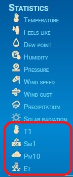

I probably missed some steps ...
but how did you Davide to add the extra sensors in the climate statistics?
thanks
thanks

Re: /pages/station/climate.php?var=xxx
I think you have to update only the attached files ( expand in pages/station directory, make a backup of the original files ).
But don't remember if these are the only changes needed ( because I made these mods together with other php 8.0 conversions ).
In the menu, to add T1 extra temperature, SM1 soil moisture and ET evapotranspiration, add something similar to:
The graph.php and graphAjax.php extend the 'Interactive graph' page adding extra sensor graphing capabilities.
T1|pages/station/redirect.php?url=climate.php?var=T1|mticon-temp
SM1|pages/station/redirect.php?url=climate.php?var=SM1|mticon-soilmoisture
ET|pages/station/redirect.php?url=climate.php?var=ET|mticon-evapotranspiration

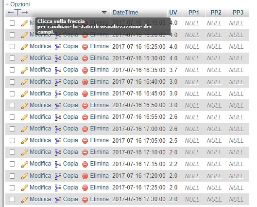

Ciao Davide,
avendo iniziato a registrare i dati PP1-2-3 da pochi giorni con MB nano ma l'archivio alldataExtra contiene già i dati UV dal 2017, mi ritrovo con dati PP1-2-3 a null che sballano le statistiche.
come posso sostituire i null con 0 nel database? o meglio, se cancello fisicamente da phpMyadmin si ricrea poi in automatico?
grazie
No, il valore corretto ( per i dati mancanti ) è null. Il problema è che meteotemplate ( a volte ) non tratta correttamente i dati incompleti ( come nel tuo caso ).
Allega un backup della tabella alldataExtra ( mi basta l'ultimo anno ) e vedo di correggerlo.
The correct value ( for missing data ) is null. The problem is that meteotemplate ( sometimes ) is not good at dealing with incomplete data ( as in your case ).
Attach a backup of the alldataExtra table ( last year is enough ) I'll try to fix it.

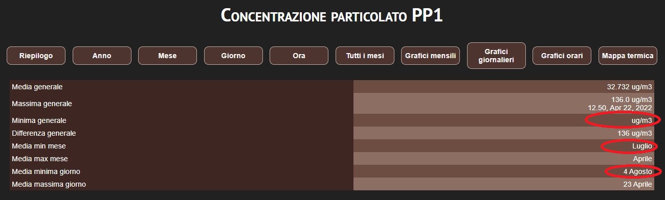

- added UV to available sensors
- you can specify the page heading passing parameter title ( to climate.php script )
In menu add something like this:
For the PP1-PP3 showing incorrect min/max try deleting the cache files ( will be automatically regenerated )

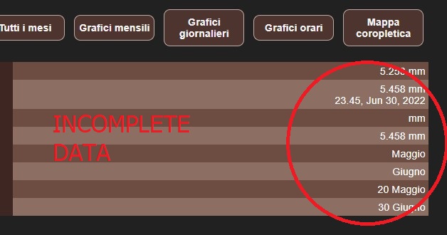

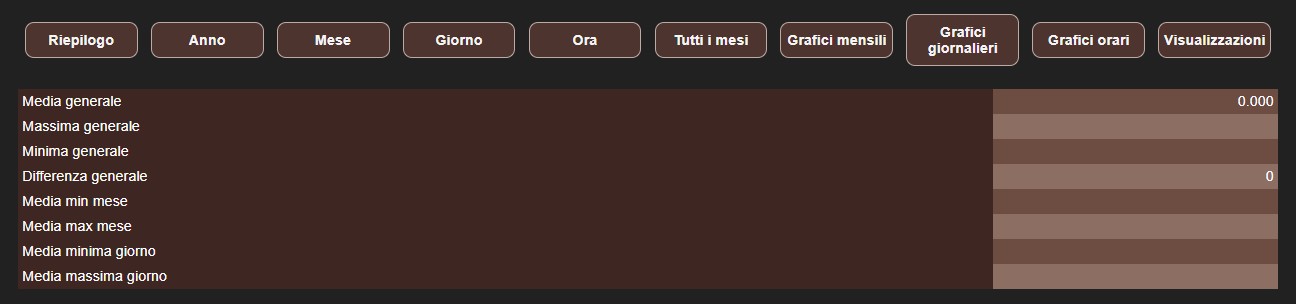

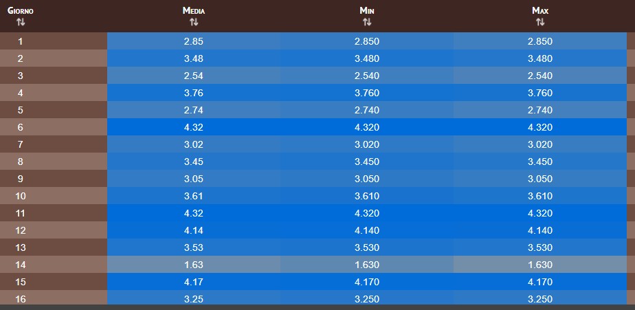

Evapotranspiration:
https://meteoesine.it/template/pages/st ... nspiration
I have noticed that the data seems not complete and fully correct
If I clear the cache the data shown are correct, but as soon as I reload the page again it appears as before.
Most probably I don't have the latest version, possibly you can share the updated full version containg also the possibility to see lightning data?
another question about ET data: is it right that the database archives only and exclusively the values from 23:45 to 00:00 of the next day?
many thanks in advance
Evapotranspiration:
- ScreenShot01082.jpg (45.17 KiB) Viewed 44798 times
- ScreenShot01083.jpg (25.79 KiB) Viewed 44798 times

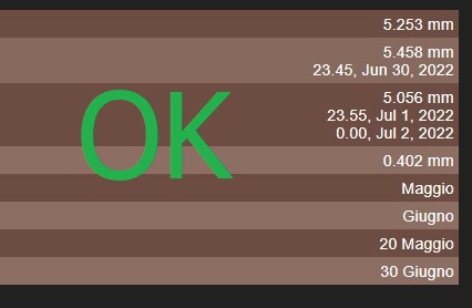

Should have fixed the cache problem, the incorrect extra temperature conversion ( °C <-> °F ) and reintroduced Feels Like stats.
All available sensors should be supported ( in stats and interactive graph page )

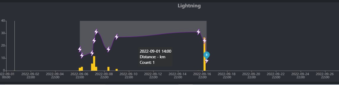

hello
for lightning
Would it be possible to reset the data at midnight on the new day to prevent the previous day's data from being carried over to the next day and bust the statistics?
There is obviously something wrong
to fix also the evapotranspiration
thanks in advance
You may try this updated api.php script, it should fix the zeroing of L and ET at 00:00
Regarding the evapotranspiration table you posted, it could be ok ( if you have only 1 year of recording )
As every row represent average/min/max of all values recorded in the same day of the year.

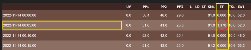

Ciao,
yes, data is reset at 00:00 but reappears at 00:05 then it is reset again at 00:10
tnx
tnx

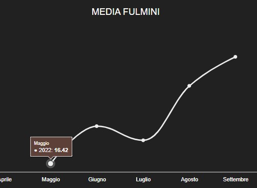

https://meteoesine.it/template/pages/st ... .php?var=L
for the lightning statistics is it possible to have the cumulative data month/year instead of the daily max? (as in the rain statistic)
