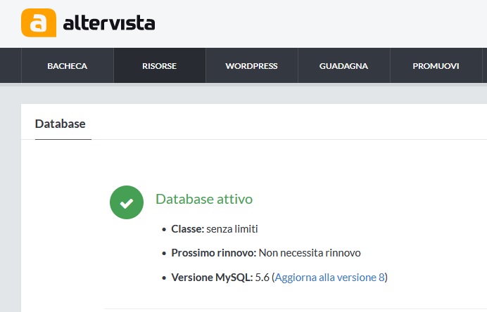

I confirm that I also installed the 19.0 version, enabled first PHP8.2 In Altervista without errors, slowly I see how it behaves because some Bolcks do not load anymore but, if I remember correctly some of them were an updated version of @davidefa and maybe I will have to restore them.
More than anything else, someone can tell me if now I owe or not also update MySQL from version 5.6 to version 8 in Altervista? I am not very experienced and I would not like to do damage especially at the database.
MySQL Altervista.jpg (39.51 KiB) Viewed 76142 times
Thanks in advance
