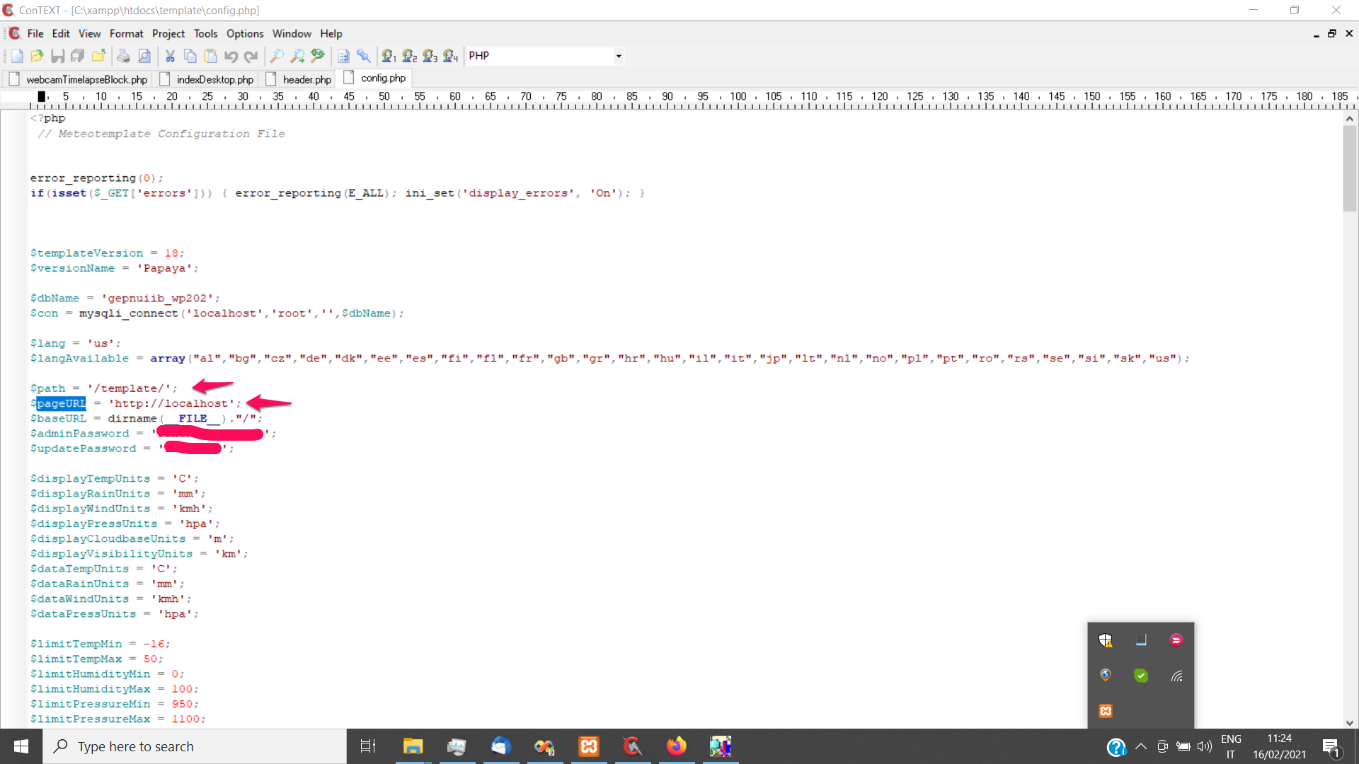

Yes, you can move your site quite easily:
1) zip the original site
2) unzip the archive on the new site ( I know you already imagined these two points ; - )
3) on the new site edit config.php, you need to change the $pageURL and $path lines to reflect the new site url
4) if you changed database, you need to update, also, database parameters ( a few lines above ), $dbName and $con ( the parameters on mysqli_connect are: ip address of the database server, username, password and database name )
4a) in this case you should also backup your original database and restore it on the new one database server
I think the last two steps is all you need.
If you point your browser to ( note the ?errors at the end ):
https://www.meteo-estaimpuis.be/templat ... php?errors
you can see the error that is blocking your new site ( usefull for debugging )

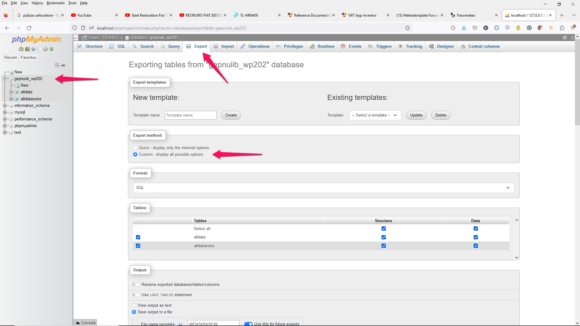

Yes you have to create the database.
If you have previous data to import ( as in your case I think ) you can create it directly in the backup/restore process:
1) in the old database manager ( phpmyadmin I assume ) export the database ( make sure the 'create database' option is checked/on, it is available once the Custom option is selected )
2) in the new database manager import the previously saved data ( the database will be created and data imported )
Now you should be good to go ( remember to set, in config.php, the ip address of new database server, database name, user and password )
Forgot to add, once everything is ok:
- you should update the database method you selected
- if you have cron jobs on the old site you should update their urls

It seems you don't have privileges to create a database.
In this case your hosting provider has already created a database for you.
If this is the case:
- in previous point 1) do not check create database option
- in previous point 2) select the database your provider has crated for you, and then import the file created in point 1)
Regarding your site not showing properly, double check in config.php you sould have:
$path = '/template/';
if I'm not wrong you have instead:
$path = '/meteoej107/';

Post by steph » Thu Oct 12, 2023 6:18 am
Salut,
bon la base de données c'est ok tout est niquel
je vais essayer de voir pourquoi le site ne charge pas maintenant car il est bien en
donc je vais regarder ça aujourd'hui ; )
