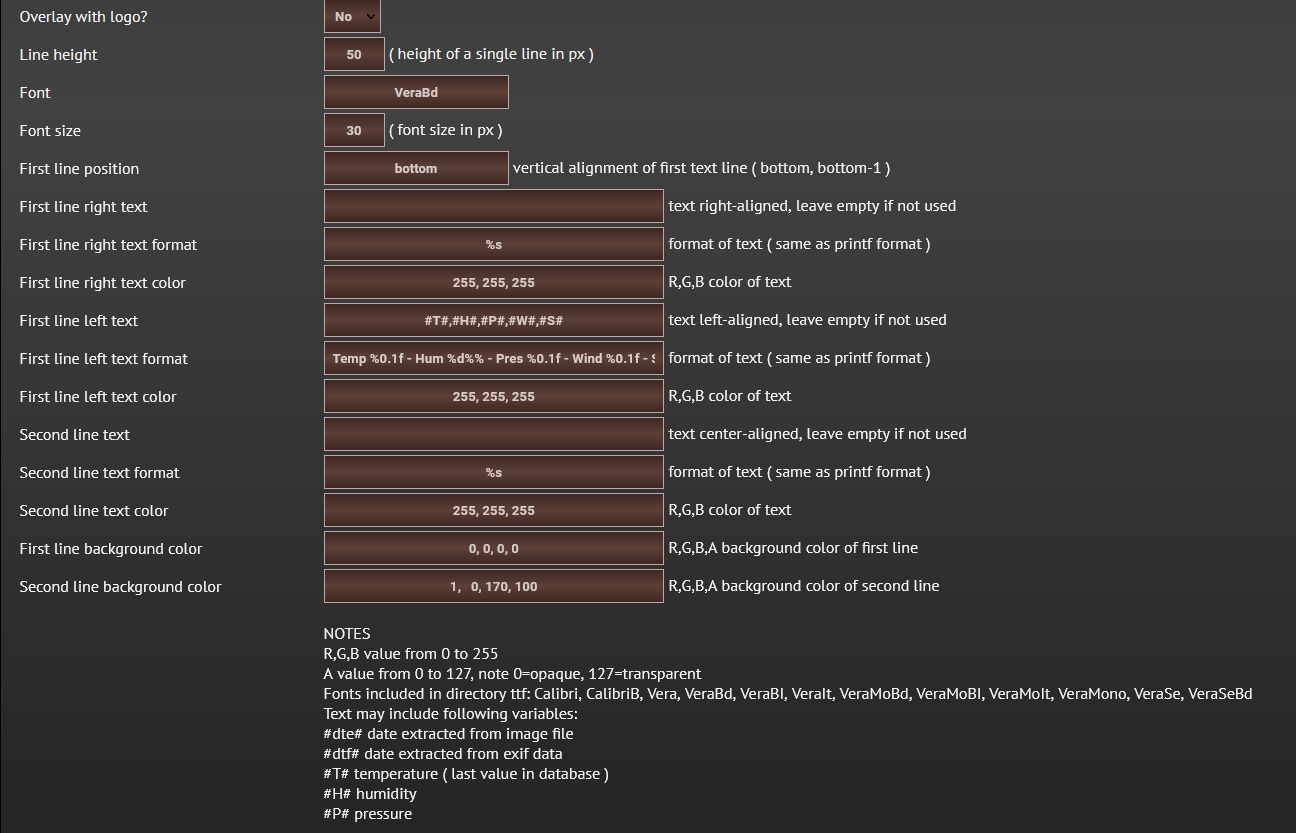

Hi @davidefa,
now I also update the V3.2 plugin, but I wanted to ask you if formatting has also changed in the settings of the webcamRename plugins, because I can't show anything or only partially:
I enlarged Line Height at 50 (I couldn't see well);
I set font size at 30 (I wanted to try to see if I could better read the characters);
I left empty First Line Right Text (I don't care about the date because it already activates on the Cam);
In First Line Left Text I set #T#,#H#,#P#,#W#,#S# ;
In First Line Left Text Format I set Temp %0.1f - Hum %d%% - Pres %0.1f - Wind %0.1f - Sun %d (as indicated in your old post viewtopic.php?t=2030&hilit=WebcamRename);
Since I want to view only one line, I left the second text field empty;
Finally, since I would like to be a possibly transparent color background, I set all the RGB values to 0 including the Alpha (which I seem to have understood that it serves for opacity).
I hope I have not made a slaughter!

Re: Webcam plugin and Webcam block problem
Post by davidefa » Sun Nov 05, 2023 2:31 pm
Could you pm me your settings.php file, as I can see your webcam.jpg is updated but not the webcam1.jpg ( and I can see no apparent error ), so I can test on my server

Post by davidefa » Sun Nov 05, 2023 5:38 pm
@amonphi
There is a small bug in the plugin ( if the left or right part of the first line is empty entire line is not displayed )
Ver 1.6 fixes it.
