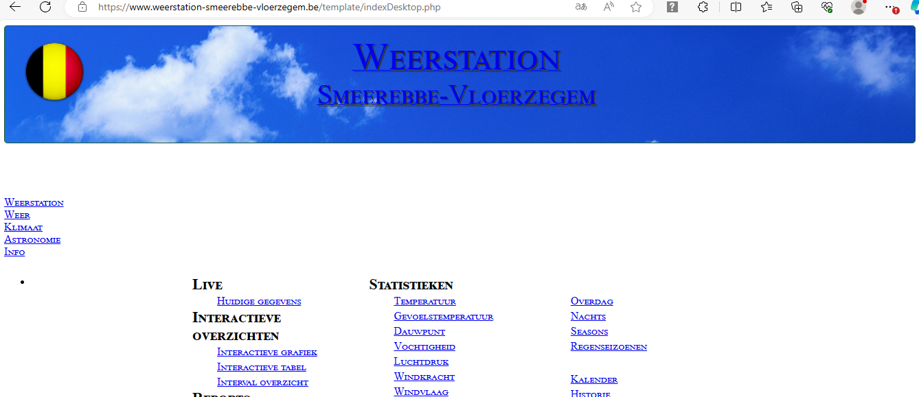

I update meteotemplate from version 18.0 to version 19.0. Everything went well as it should and the template was updated successfully. But now the webpages do not show as they should. Firefox displays it as it should, but in Chrome and Edge, nothing is displayed normally.
Could you please check (if possible) my webpage and help to find out why the pages are not displayed right?

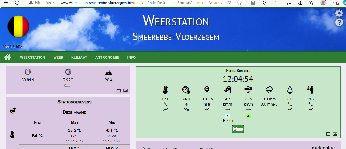

Seems an issue with http/https: When calling your site with http, all looks fine.
HTTP:
HTTPS:

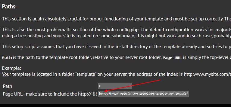

Did you put https in your configuration?
Good day

Hello Jose,
You're right. I forgot to include this small but very important detail. Everything works fine now!
