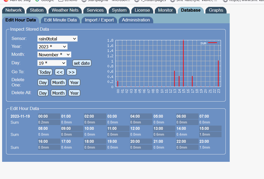

Hi all,
If I have rain just before midnight and stopped before midnight,
the value is carried over to the next day, at 00:00 and counter is reset at 00:05.
causing my rainvalues to increase faulty.
The built in rain check (data editing) tool should fix this, but seems not be working anymore.
Any ideas?

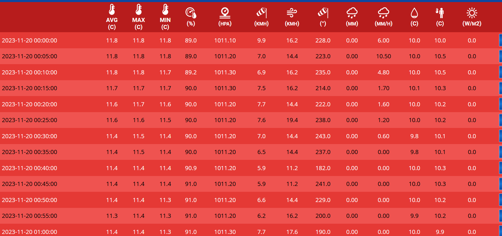

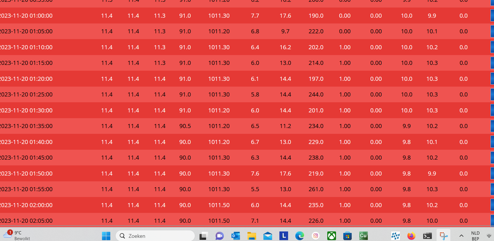

I think the issue has something to do with rain accumulation not having the right time,
i notices several times taht at midnight rollover the rain is 1 hour off.
maybe to do with UT and CET time?
I added some screenshots.
Since it rains a lot these days, I have this issue every day.

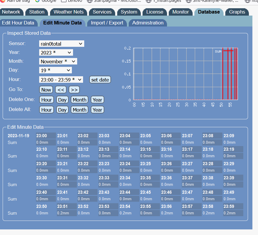

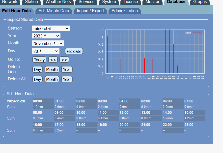

Re: rain check over midnight
and now from MT
