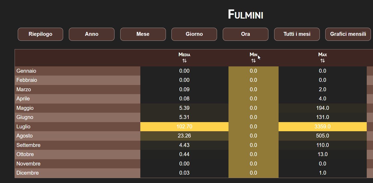

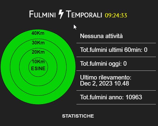

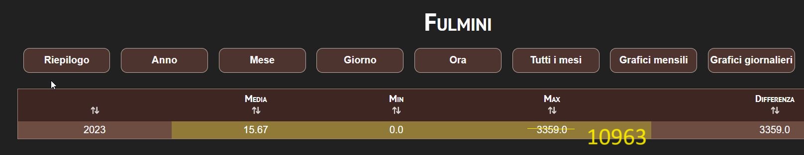

in the lightning statistics I noticed that over the various months (and years) it does not add up all the values but only reports the highest number of lightning strikes recorded in the period. Let me explain:
https://meteoesine.it/template/pages/st ... =lightning
this year I recorded a total of 10963 lightning strikes.
the total for the year gives me 3559 which is the number of lightning strikes recorded on July 12th;
the same for all months: it only displays the number of lightning strikes on the day that recorded the highest number of lightning strikes.
A sum should be made (per month and per year) as is done for rain statistics.
tnx in advance
