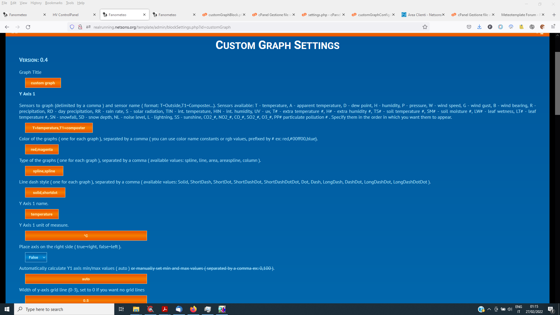

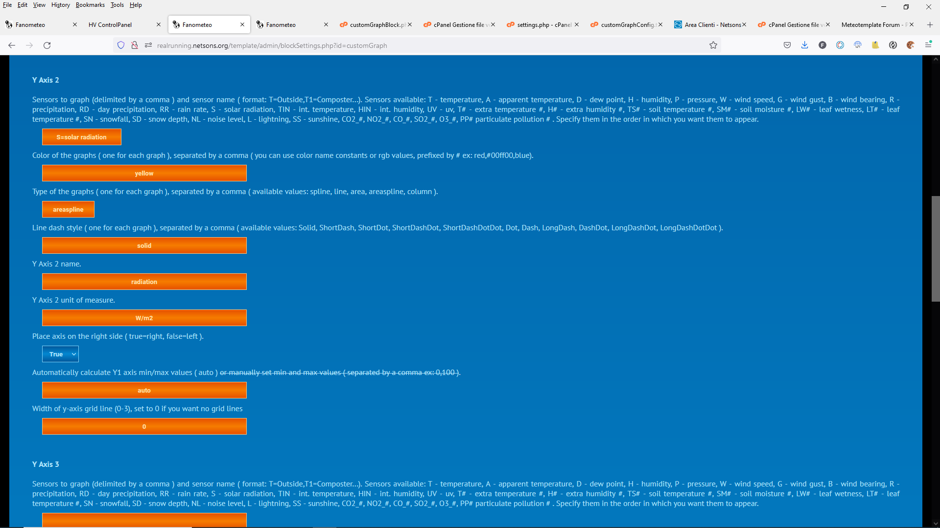

new customGraph block
v0.4
It is a customizable graph block derived from interactiveGraph block.
Highly configurable, shows any number of sensors on max 4 axes.
It is still a preview ( not fully tested/completed ), but quite functional
- customGraph_0.4.zip
- (9.2 KiB) Downloaded 1073 times

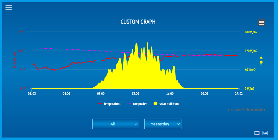

As a user loving the customgraph block, I want to point out that it does not show negative temperatures.

Currently there are a few issues with this on https://broekermeer.nl
- the graph shows % instead of degrees Celsius and W/m2, and it does not show T values below zero..
- Plus, at first loading of the site, the graph does not pick anything for time-scale, keeps showing a turning/loading symbol, until you change the Time-scale value. It should default to [24h] but it does not.
Any idea, davide?

Watch out for the frost coming Monday-Tuesday-Wednesday, so you'll see how the graph fails to show below zero temps.. (and its still shows % instead of degrees C and W/m2..)
Re: new customGraph block
I checked your settings and are correct ( if you show the block fullscreen it is displayed correctly ).
The problem seems to be an unwanted interaction with block windRose, I modified both blocks and it seem working ( at least on my sites ).
