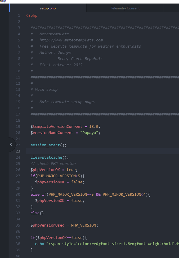

Thanks again for your feedback,
In fact the Header folder concerns 3 files and the setup.php file is clearly stipulated above
$templateVersionCurrent = 18.0;
$versionNameCurrent = "Papaya";
See Attachment.
Capture d'écran 2023-09-13 121110.png (64.48 KiB) Viewed 47101 times
So that took me straight back to version 18.
As for the Functions.php file, that's ok, I can modify it if it's not correct.
in which folder is the Functions.php.fs file?
Because the function.php file that I have in Scripts is more recent than the one you sent.
THANKS

The version information 18.0 is just a text string and was not modified. This does not indicate that the template files have been reversed back to this version.
Same for "Papaya", you can modify both strings to 19.0 and Cranberry if you feel better.
The function.php is in /templateroot/scripts, save the old one and copy the one from archive.

So I don't know,
I updated template 19
then I reinstalled the header-ib folder so the 3 files
setup.php
header.php
createconfig.php
And by doing this it brought me back to version 18.
So I reinstalled version 19.
But now I no longer dare to put the header-ib folder because I know that it will automatically revert to version 18.
For the Functions.php file I will transfer it.
THANKS

NO! I does not revert anything!
It is just a text string without any function. You can write 122.0 or any other version, it does NOT revert anything!
