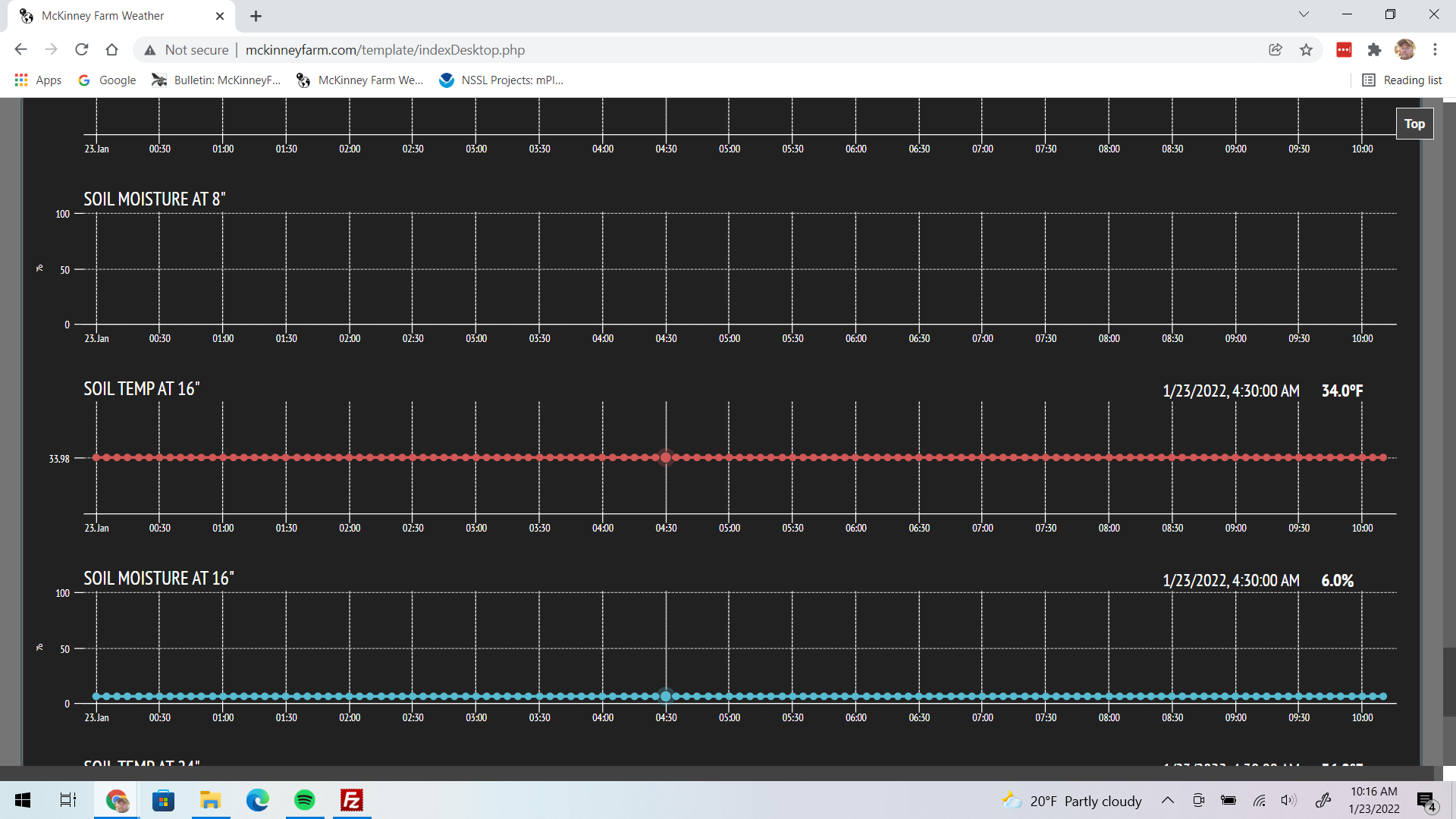

- soilmoisture1.png (195.42 KiB) Viewed 58031 times

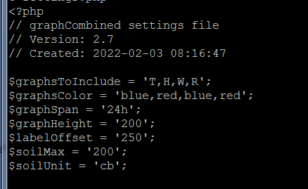

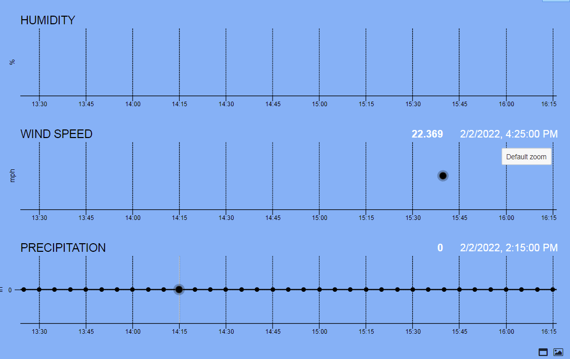

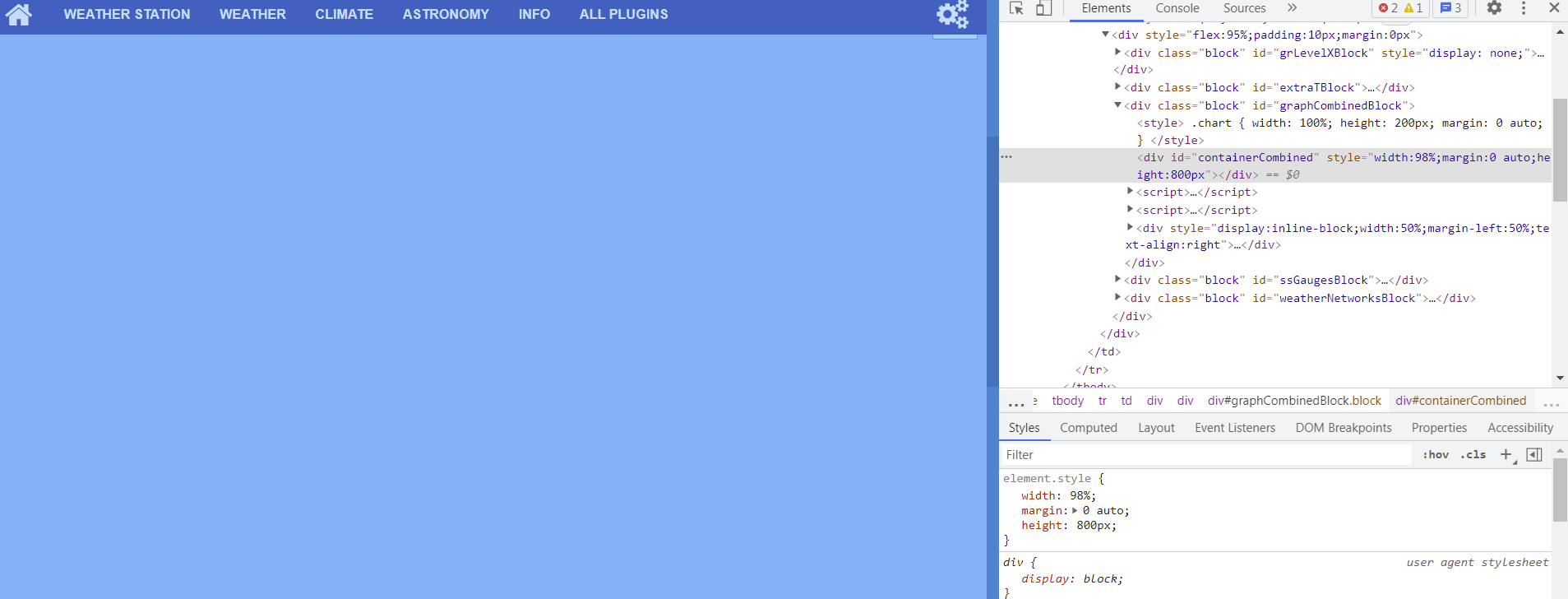

Update/recap on what I've done.
1) install 2.0, works, inspect shows svg statements in the page for graph (see image)
2) clean install 2.7, blank page, no svg statements (see image)
3) rollback to 2.0, leave 2.7 settings, works (see image)
4) change to 2.7, use 2.0 data.php works
5) 2.7 with 2.1a data.php, no svg on the page.
didn't try other combinations.
**** forum isn't letting me add more attachments, so data.php output in next post
2.0 screen capture 2.7 screen capture 2.7 settings

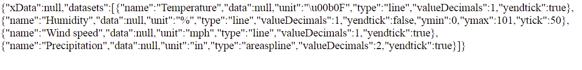

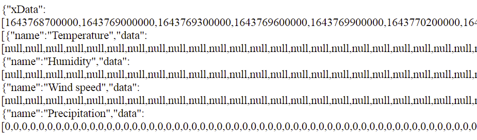

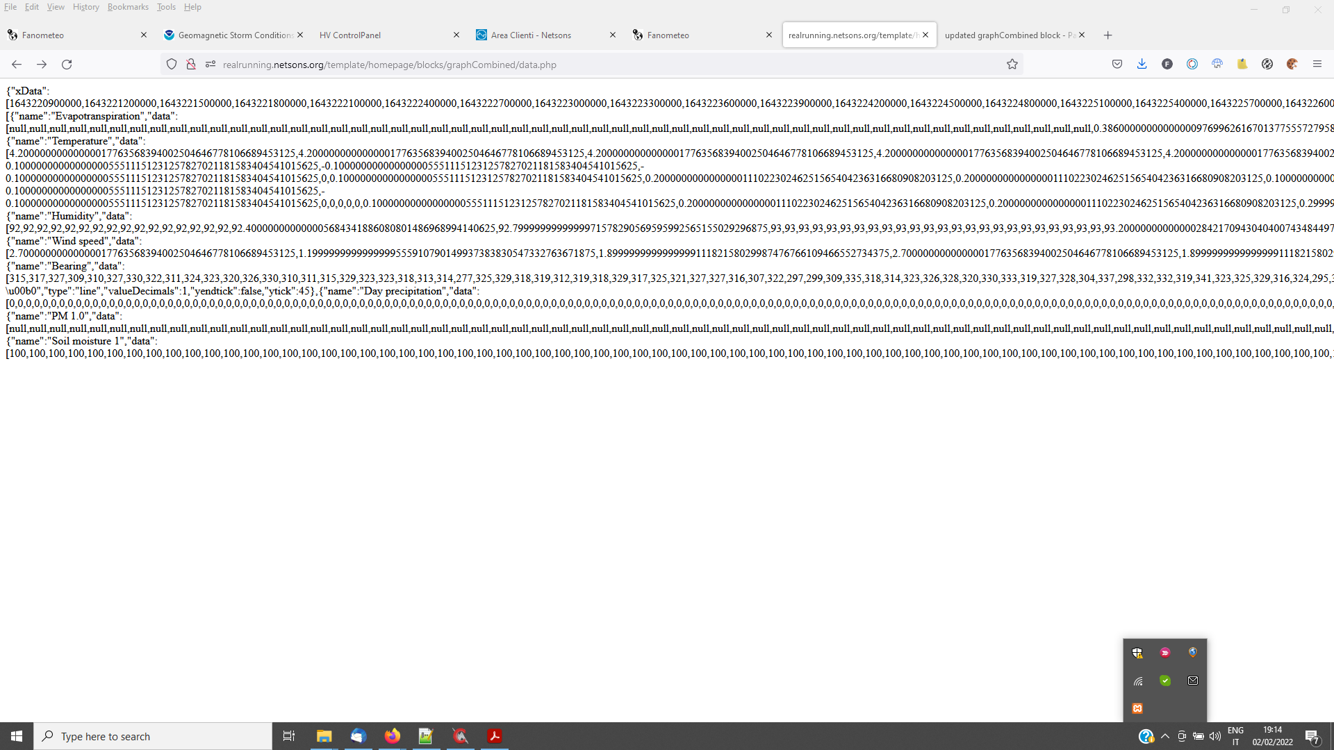

data.php output from 2.0
data.php output from 2.7
yes, there should be lots of 0's and null's. My meteobridge is running but still waiting to get my Davis station
Let me know if you want me to try something else.
Thanks!!!
Thanks!!!
Re: updated graphCombined block
Ok, if I understand correctly, you ( both of you ) don't have any extra sensor setup so the data.php fails ( thanks to Lemimi for pointing this out ). In this case you can use the data.php of v2.0.
Later I'll post an updated version ( after verifying everything works as expected )

I get an empty block on my mobile device. Desktop layout works fine.
Nothing to see in the error.log for this block. Also no error in this block when I use indexMobile.php?errors.
Today also installed version 3.0.
What could be wrong here?
