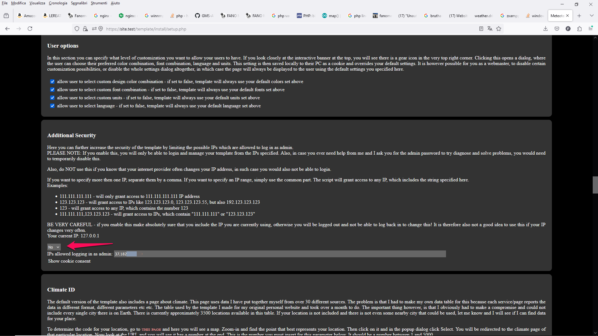

Also if you enabled the 'Additional Security' option in the main setup you are allowed to access the administrative pages only from the supplied adresses.
If this is the case and you can't login from those addresses anymore, I think you can edit the config.php script near line 152 and:
a) set $enableAdminIP to false ( so you can use any ip to access the admin panel )
or
b) set $adminIPs to the ip you are using now ( you can insert multiple ips separated by commas )
$enableAdminIP = false;
$adminIPs = 'xxx.yyy.zzz.www';

davidefa wrote: Thu Jan 02, 2025 5:25 pm Also if you enabled the 'Additional Security' option in the main setup you are allowed to access the administrative pages only from the supplied adresses.
or
Thanks - yes, was already false that one it seems, so does't help unfortunately!
