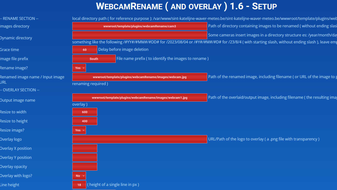

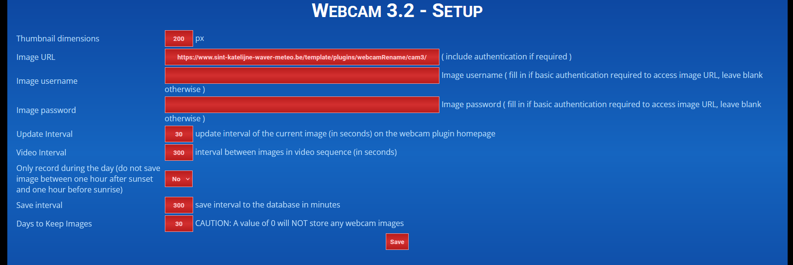

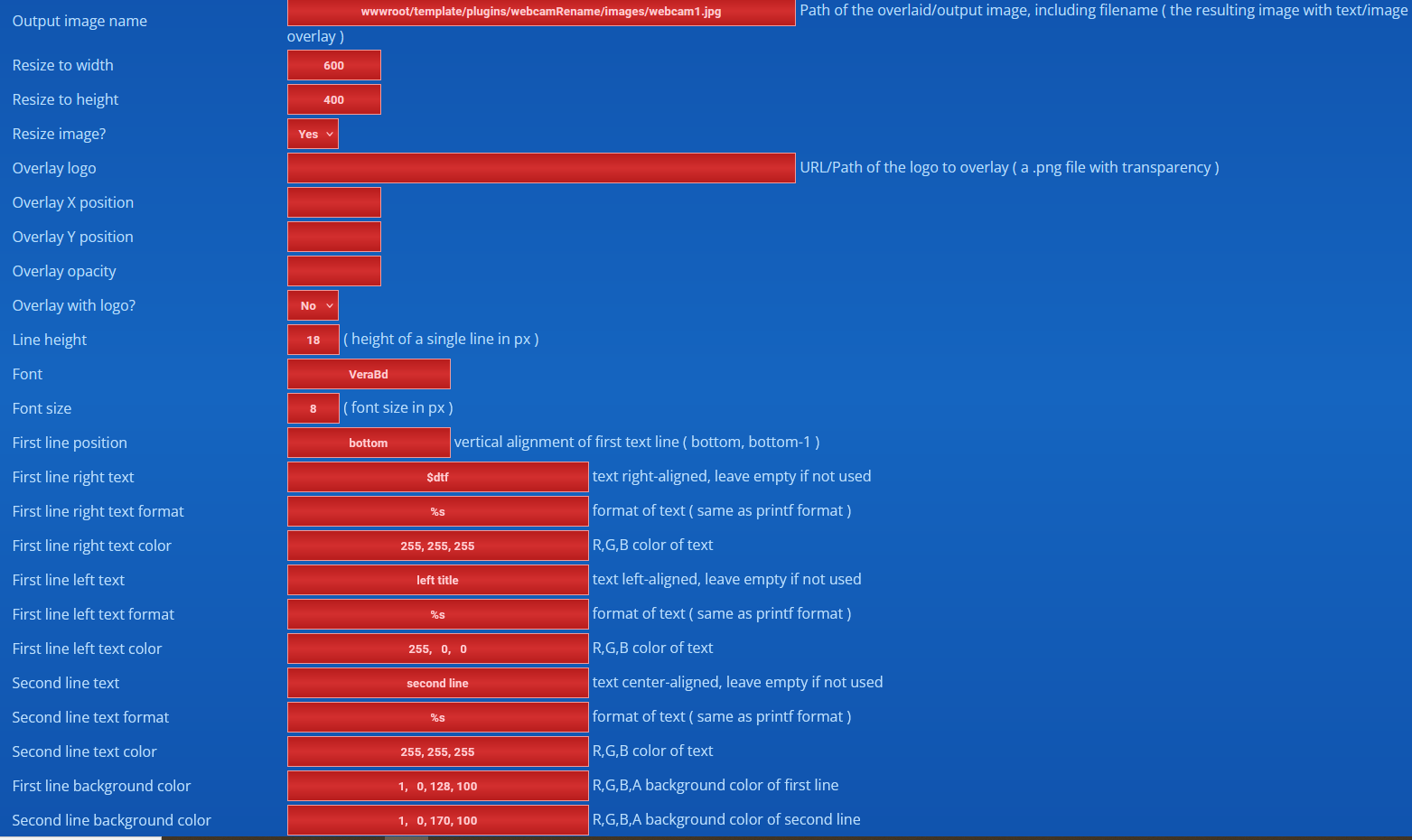

I managed the get a picture on my site https://sint-katelijne-waver-meteo.be/t ... esktop.php.
It gets into the wwwroot/template/plugins/webcamRename/cam3 folder as webcam.jpg
It has been sent there by a ftp request by meteobridge.
It is for now unclear to me how webcamrename and webcam plugin work.
See attachments for my present setup.

all is working,
even webcamRename
can I add multiple data like #T# and #P# and #R#???
thanks
