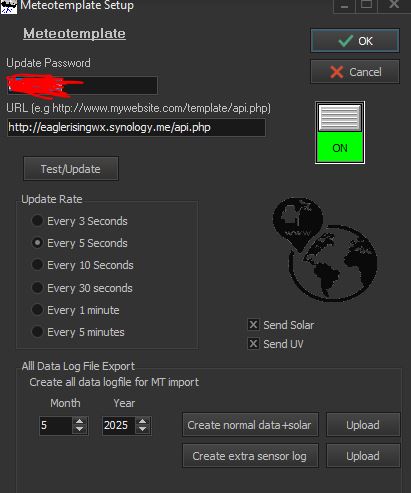

Looking for some suggestions for troubleshooting an API error that just started happening within the past 24 hours. Up to this point, everything has been working flawlessly. Below is a quick summary of the problem:
1. I have attached a snipit of the Weather Display MeteoTemplate configuration. How it is/was set up while it still worked.

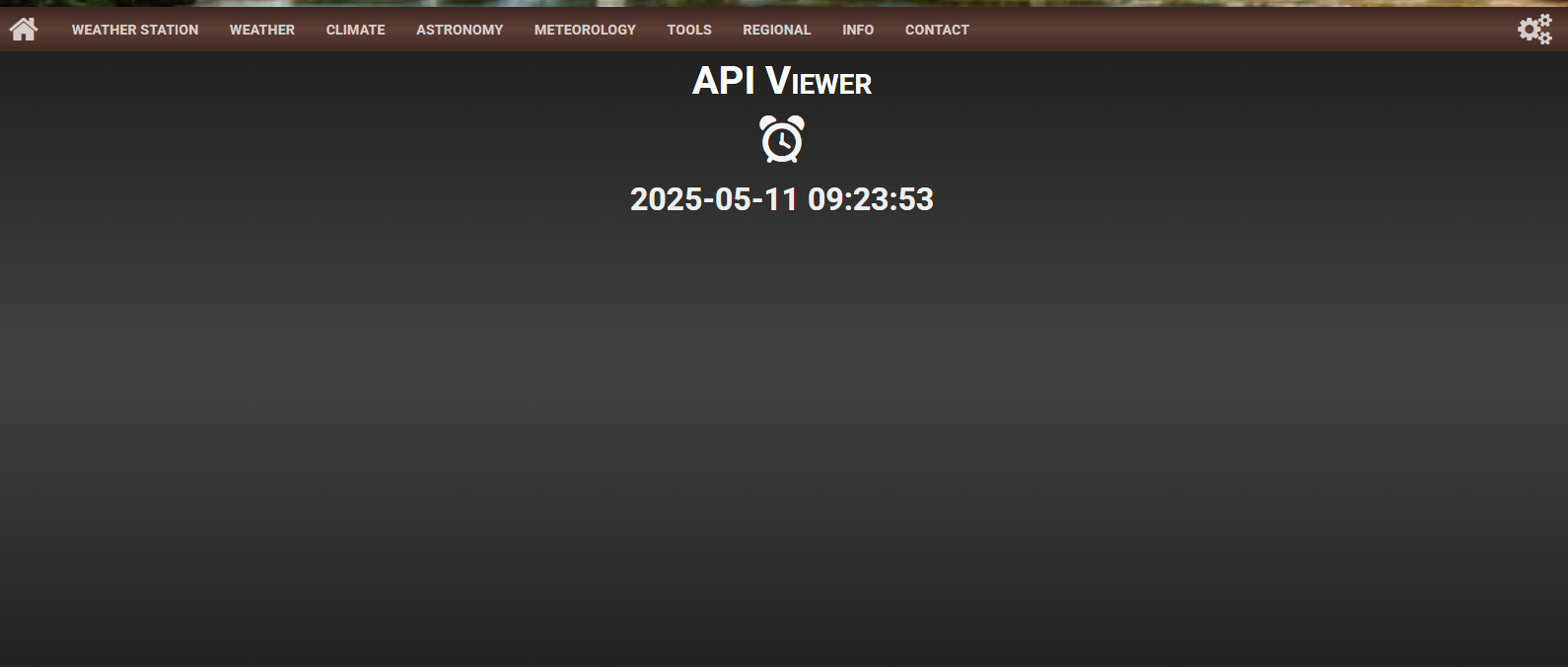

7. When I click on the "API Viewer" link from the "Tools" menu, the Date Time Group continues to update as if the API is getting called from Weather Display but nothing is added to the Cache folder or into the SQL DB (see attached snipit
MeteoTemplate API Tool Snipit
API_Tool snipit.png (53.95 KiB) Viewed 12870 times
8. When I attempt to manually call the API via the web browser, I receive "No password provided".
