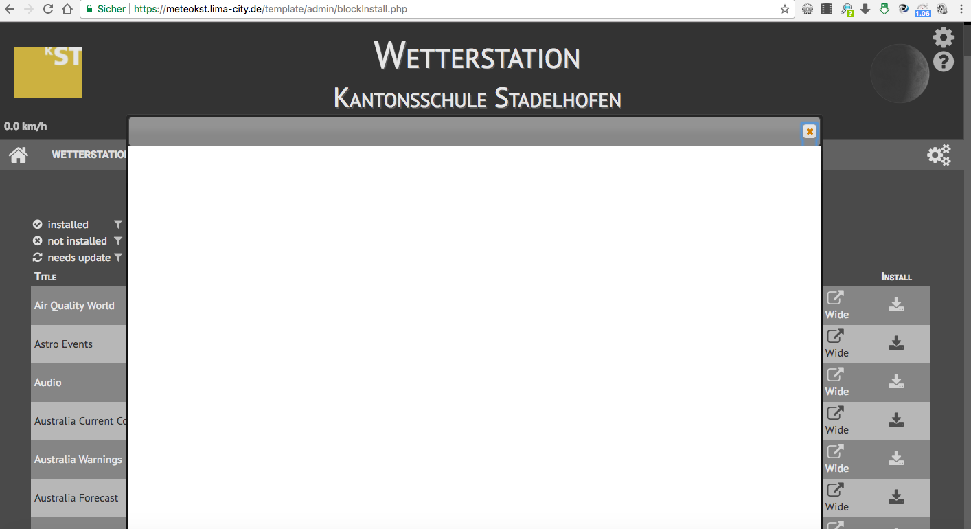

I'm new to Meteotemplate and I try to install Blocks in the control panel.
  • choose a Block
  • klick on the download link
  • confirm the dialogbox: Do you really want to install this block?
  • a white popup window opens
  • nothing hapens...
when I manualy install the block an upload it to the apropriate directory: https://meteokst.lima-city.de/template/blocks/meteogram I can't see the mentioned block in the List of the blocks in the configuration page.
I would be very thankfull for any help.
Bildschirmfoto 2017-09-27 um 19.39.08.png (119.55 KiB) Viewed 3155 times

I think the problem is in https. I see from the screenshot you are using https. This is a problem because your server refuses to load data from my server (which is not https). Unfortunately you will have to update and install things manually.
