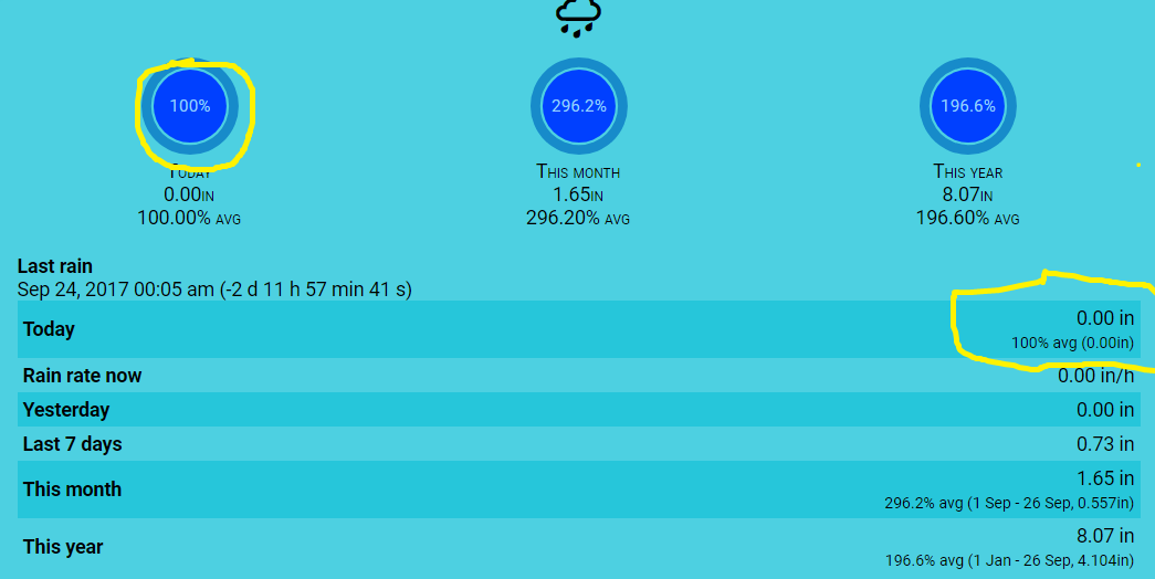

During the past week we have received a lot of precipitation (for us, we live in a semi-arid area) so I have been getting increased web traffic checking on rainfall. Which is great, it's all about web traffic for me.
One of my website users contacted me asking why 0" of rain today shows as 100% of average.
I'm not sure of the explanation.
Screenshot of issue.
any suggestions?
Terry
Re: Rain block
Post by Jachym » Tue Sep 26, 2017 7:08 pm
It means that all 25 Sep in your db have 0 rain, so even 0 is technically speaking 100% of avg
WyoDog
Posts: 67
Location: Powell, WY USA
Re: Rain block
Post by WyoDog » Wed Sep 27, 2017 12:13 am
Hey Jachym
That makes perfect sense. Sometimes I tend to overlook the obvious.
thanks
Terry
