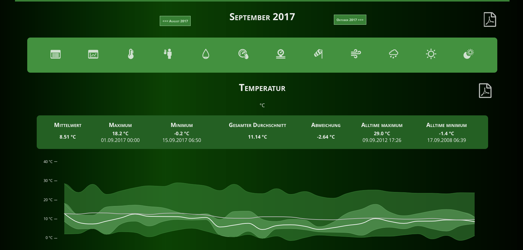

Sorry to be annoying - but I cannot confirm. At least I am blind and cannot see it, but in Reports (Month or Year) there is no single hint to a "normal":
Bildschirmfoto 2017-10-13 um 18.03.15.png (170.73 KiB) Viewed 22774 times
Re: Normals introduced in version 16
Post by Jachym » Fri Oct 13, 2017 4:56 pm
Summary table of the report
Reinhard
Posts: 84
Software: WeatherCat
Post by Reinhard » Sat Oct 14, 2017 7:42 am
Thanks for your patience - got it now! :D
