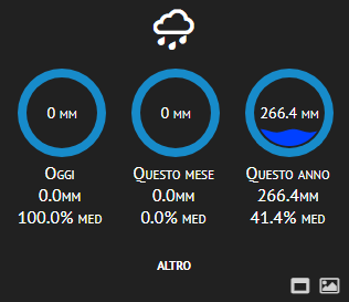

0 today is 0%, not 100% (see attach)

It is ok.
If in your database, rain for every Oct 20/21 is 0, it means that the highest rain ever on this day was 0mm. And 0 mm of 0mm is technically 100%.

it is completely misleading to have a full circle for today when the rain is 0...... (and also, something divided by 0 is a math error, not 100).
Also note that the second circle is working fine: 0 this month, so 0. Why 0 today is 100?
is it possibile to have the absolute value without % comparison?

Solved with a workaround: Show comparison to average period if available. = FALSE

ya you are right. It is still not comprehensible to me the why for the day 0 is 100% and for the month 0 is 0%
