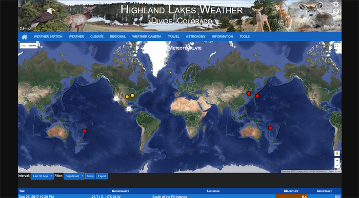

Right John
Go here
http://www.highlandlakesweather.net/tem ... /index.php
(dmgould's site )
then select
30 days Interval
All as filter
click show
I see nothing, You????
niko
Re: Earthquakes plugin
Post by Jachym » Sun Oct 01, 2017 8:59 am
No issues
The only thing I would recommend is changing the top header bg image, some people will find it difficult to read, or maybe make it a bit darker to make the title/subtitle stand out a bit more :)
Highland Lakes Weather.png (415.46 KiB) Viewed 30675 times

Jachim sorry
Have you tried after this, selecting 30 days and all and the clicking show?
Not the last significant
niko
Post by Jachym » Sun Oct 01, 2017 12:19 pm
last 30 days + all results in a very large amount of EQs, which in your case overflows the max allowed memory for PHP
http://www.highlandlakesweather.net/tem ... extent=all
