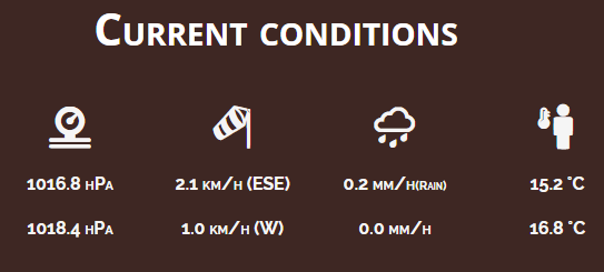

In menu weather -> outlook -> current conditions the precipitation value is never updated and always 0. Is this just my problem? (i use Netatmo plugin). In all other parts of the template, the value is updated correctly. In the screenshot below, first row is METAR station, second raw is mine.

This is rain rate, not precipitation and I know that NetAtmo not always reports this correctly

English label icon is "precipitation" ;) Therefore, the strange thing is that this value is reported correctly in home page and in other statistics...

Post by Jachym » Fri Nov 03, 2017 11:01 am
When you see mm/h or in/h it is always rain rate

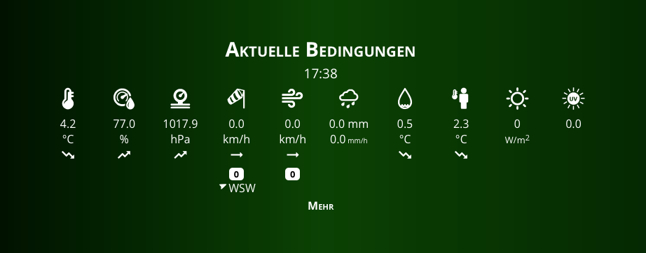

Another remark. In the "current conditions" block, also when this is displayed at 100% width, the rain rate "mm/h" appear wrapped ("h" slip to the bottom line). Can you do something? I think would be really good if it looks good at least up to two full digits.

adelrosso wrote: Fri Nov 03, 2017 11:52 am Another remark. In the "current conditions" block, also when this is displayed at 100% width, the rain rate "mm/h" appear wrapped ("h" slip to the bottom line). Can you do something? I think would be really good if it looks good at least up to two full digits.
The workaround: Open currentBlock.php in a text editor, go to line 302 and edit this string to the font size you want (for me it suits 0.6em):
<span style="font-size:0.6em">&nbsp;<?php echo $displayRainUnits."/".lang('hAbbr','l')?></span>
Be aware if the block gets an update - all your changes are gone.

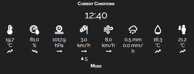

Bildschirmfoto 2017-11-03 um 17.39.25.png (53.41 KiB) Viewed 11053 times
