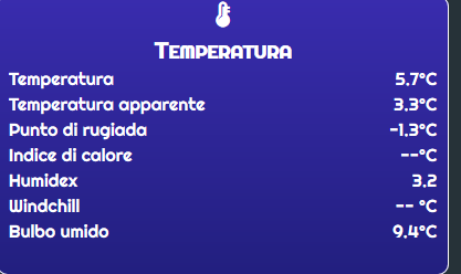

Hi
windchill value not appear in current block???
it's only my problems ??

What was the wind speed? Wind chill is only calculated below certain temperature and above certain wind speed

Post by Semtex » Sat Dec 02, 2017 5:48 pm
Is calculated by meteotemplate ??
don't use meteobridge values???

Post by Jachym » Sun Dec 03, 2017 10:27 am
no, Meteotemplate does not use MB values, there is no need for it because Meteobridge also calculates it, just like Meteotemplate can calculate it, it is not measured and can be derived from the other parameters
