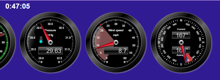

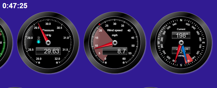

The problem I am having is that the WIND SPEED Gauge is displaying the Average Wind Speed, NOT the CURRENT wind speed.
My page refreshes the gauges every 12-15 seconds (Depending on server speed) The wind direction can clearly be seen updating.
Wind speed remains constant, even though it dropped 1.5 MPH in this time period.
