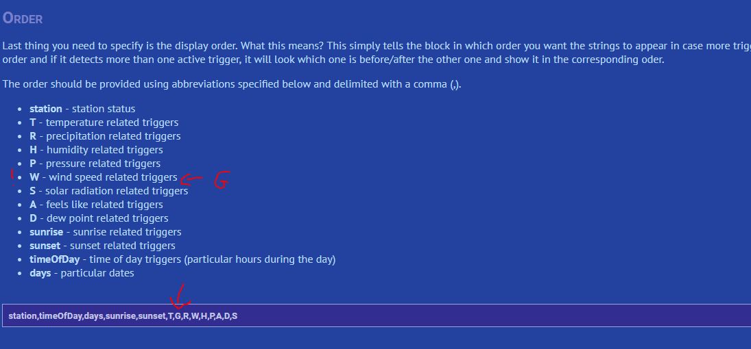

actually i've a lot of wind gust around 60/70 kmh.
I've set dynamic text to show a message if wind gust speed goes over 50 kmh (for test i've set it to 22) but no message is showed.
Any ideas?
Screeshots:
Thank you so much.
Alessandro

Post by polbrieuc » Sun Dec 10, 2017 2:00 pm
I had the same issue and it is quite simple to fix.
The legend "W - wind speed related triggers" is wrong, the correct label for Wind alert is "G"
As the value G is missing in the list of alerts at the bottom of the setup page, nothing is displayed.
Just add G somewhere in the list and the gust alert should display correctly
You can also remove the W.

thank you so much about your reply.
I've set it like this:
Is it ok?
