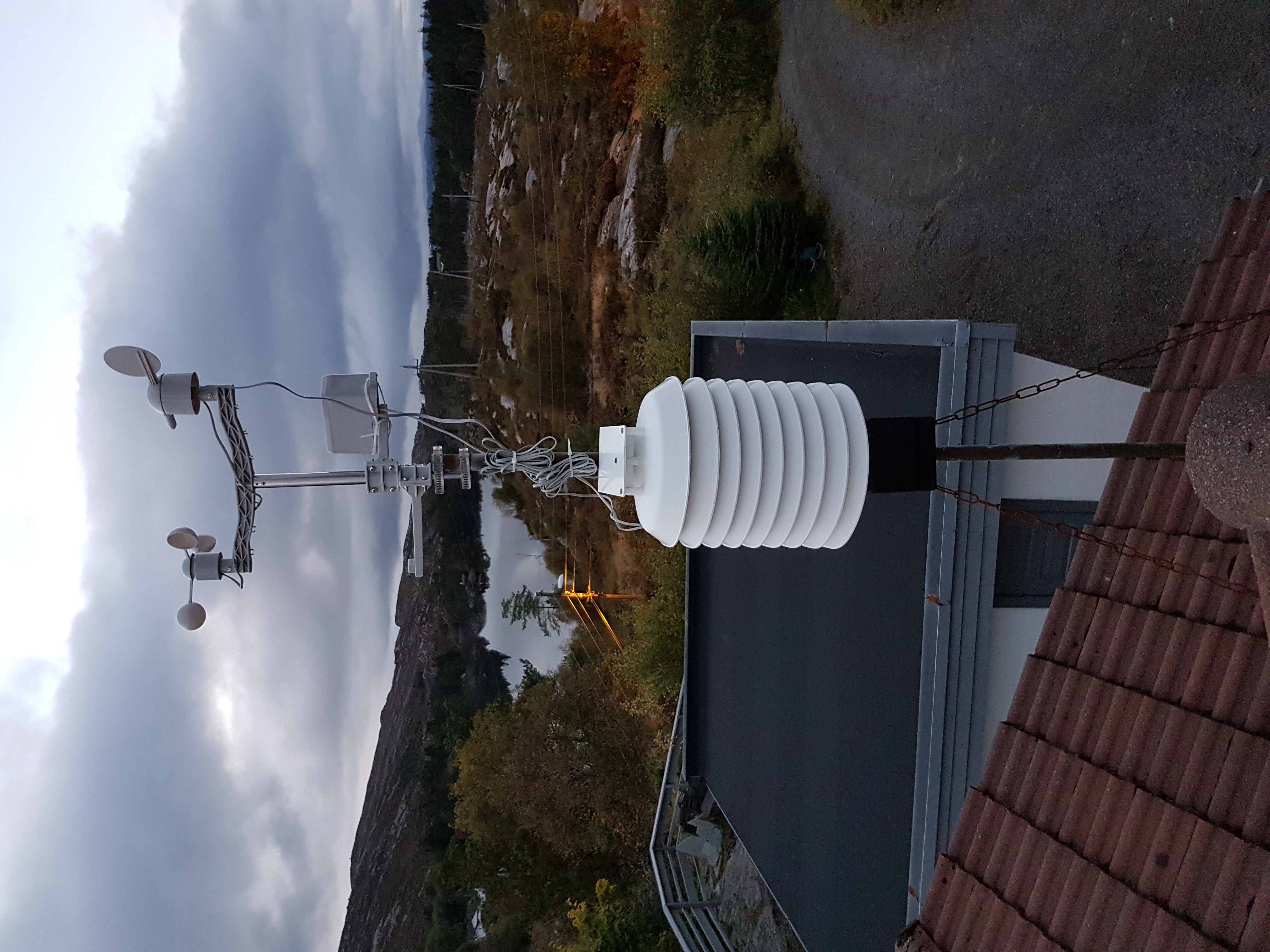

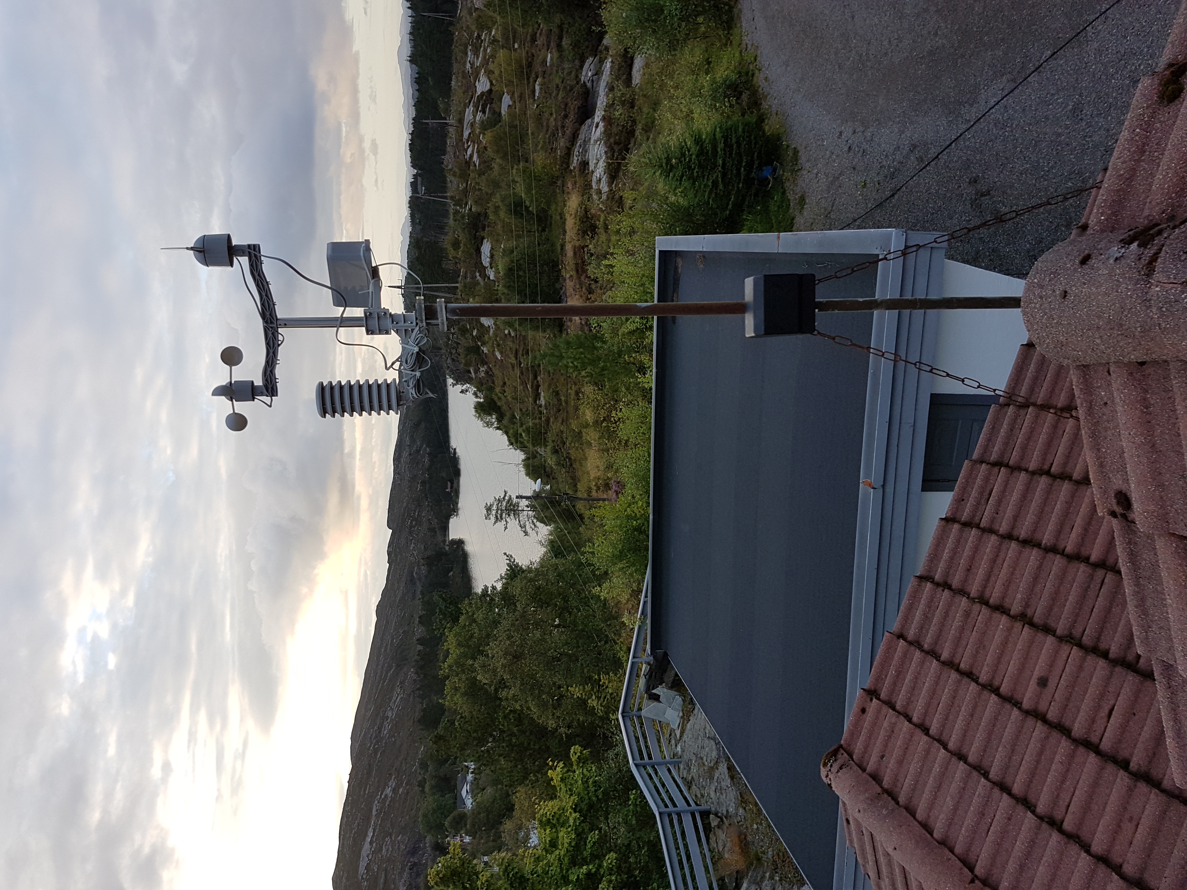

Very nice site. I see that you mention you upgraded the WH1080 with a better radiation shield.
Would you care to detail what you did exactly and maybe post a couple of pictures ?
I have the same station and I am curious about your upgrade. Did you notice the impact of your upgrade in your readings ?

Here is my original setup:
and here is a picture with the upgraded radiation shield:
Link to the new shield: https://www.ebay.com/itm/352138659926
It make a big difference. The original shield gave me 2-3 degrees too high temperatures in sunny weather, compared with nearby stations and another sensor that I have in the shadow, so the new (and big!) radiation shield is definitely worth the money
I have also made another change from the original setup. The rain gauge is now mounted at the roof top, instead of in the mast. When it was on the mast it gave too high readings in strong winds, because of the movements of the mast, which caused the tipping bucket to empty too often.

Thanks a lot. This is exactly what I need to do on my station (add a better shield and move the rain gauge)
