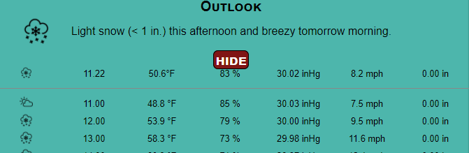

Hi guys,
I checked darksky and to solve this issue just replace units=si by units=us in this line of outlook.php:
$fIOURL = "https://api.darksky.net/forecast/".$fIOKey."/".$stationLat.",".$stationLon."?units=si&lang=".$fIOLanguage;
For outlook text with US units it should be
$fIOURL = "https://api.darksky.net/forecast/".$fIOKey."/".$stationLat.",".$stationLon."?units=us&lang=".$fIOLanguage;
This way, you will get snow outlook text in inches instead of cm.
I tried it myself for cecilweather.com lat and long and I got: "Snow (< 1 in.) tomorrow morning."

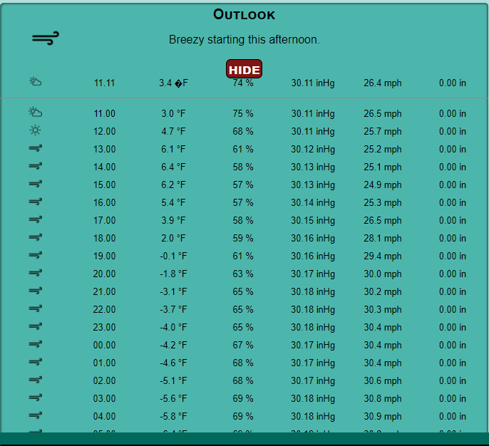

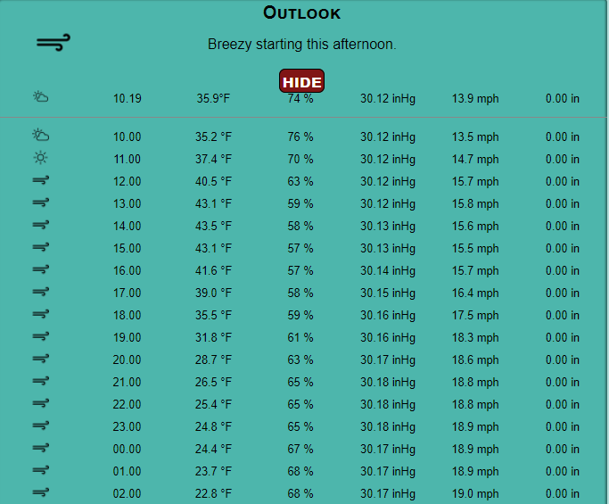

Re: Outlook block
Post by BobW55 » Fri Jan 05, 2018 5:50 am
meteocaldas
Not sure just what all you changed, But everything is now displaying properly. I have the correct imperial units, and data is matching my location.
The old PHP displayed this:
The new PHP displays this:
I really appreciate your efforts in this matter.

Post by meteocaldas » Fri Jan 05, 2018 11:40 am
BobW55 wrote: Fri Jan 05, 2018 5:50 am meteocaldas
Hi Bob, thank you so much for your testing and I am very glad to see that units and values are displaying correctly now, and that your future snow forecasts will be in inches instead of cm :-)
I am sending you a new php to correct the small ºF issue in the first line.
Paulo
http://www.meteocaldas.com/mmtp
