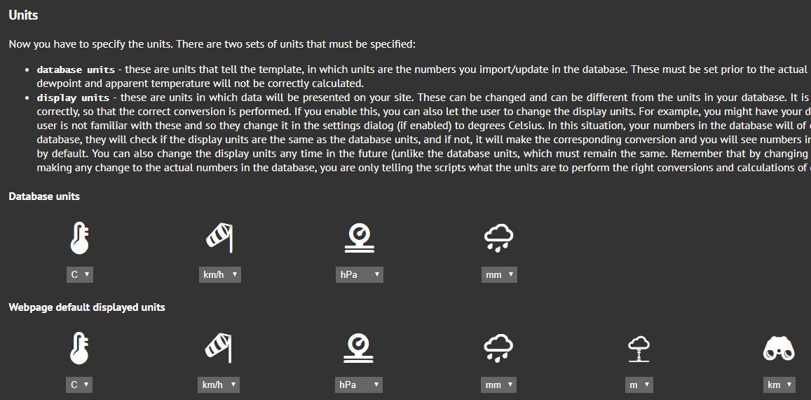

Hi Hankster, just a thought here, when you were setting up the template, did you set the correct units before your import?
Administration/Main Setup
hankster
Posts: 14
Joined: Sun Dec 10, 2017 2:23 pm
Location: SW Florida USA
Station model: Weather Flow
Re: Importing Data Issue
Post by hankster » Sun Dec 10, 2017 9:18 pm
Hi Johnny, Been working with Jachym on this. I guess I just misunderstood the Summary output with the F, inhg, etc after the data. The units are all correct and everything imported correctly.
