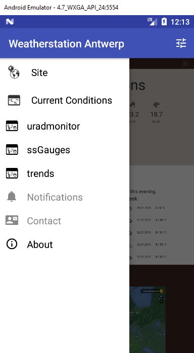

defined in de plugin(V0.4) the "current conditions" and 3 other blocks, but noting is showing up in the app ?
only Site and About is highlighted, the rest is greyed out, and the 3 block don't show up.
Did I forgot something in the plugin setup ?
Luc

Post by iatros » Thu Jan 18, 2018 6:49 am
Try:
in your device, go to settings -> apps -> Meteotemplate -> storage. Empty Cache (NOT DATA), then STOP (accept the warning) .
Restart Meteotemplate, and your changes from the plugin should appear.
cheers
Martin
Language Admin für Deutsch

Post by ON1GL » Thu Jan 18, 2018 8:41 am
no joy Martin :-(
Can see the left info bar from most other stations, not mine
Luc

Post by polbrieuc » Thu Jan 18, 2018 10:22 am
ON1GL wrote: Thu Jan 18, 2018 8:41 am no joy Martin :-(
Luc
I will have a look but it is most probably related to the way the app connects to your site (a 301 redirection or that kind of stuff).
I'll check later today or tomorrow.
Bear with me...

ON1GL wrote: Thu Jan 18, 2018 10:34 am if it can help the ip adress of the site is 44.144.11.222:7378
It seems that your site has unsual settings.
Connecting to your url using the domain is answering with an embedded iframe :
<!DOCTYPE html>
<html>
<head>
<title>weer.on1gl.be</title>
<style type="text/css">
body {
margin:0;
padding:0;
iframe {
display: block;
border: none;
height: 100vh;
width: 100vw;
</style>
</head>
<body>
<iframe src="http://44.144.11.222:7378/plugins/app/settings.txt"><p>Your user agent does not support iframes. However you may visit <a href="http://44.144.11.222:7378/plugins/app/settings.txt">the page that was supposed to be here</a></p></iframe>
</body>
</html>
This cannot be used for the purpose of the app which needs a direct answer from the site.
So I tried to connect directly through the IP address 44.144.11.222:7378
Although I can access the file correctly through a browser, I get an http 405 error (Method not allowed) from the app :
Intent to connect to http://44.144.11.222:7378/plugins/app/settings.txt result in code 405
So it seems that your site only accept strict GET method while the app was trying to use an hybrid GET method (GET in the header but still trying to use some of the POST functionnality).
I corrected the app and it now work correctly (with the IP, not using your domain):
The fix will be included in the next version of the app (as I have also other bugs to fix before releasing it) but you can download an intermediate version (made just for you) here.
You may wanto to check if your iframe-embedded stuff is absolutely needed and if not, get rid of it.
Same for your security settings that prevent POST calls
And please confirm that the IP 44.144.11.222:7378 is a static one (it not, your site will stop working in the app the next time the IP address changes).
Cheers,
Pol-Brieuc
[EDIT] : The fact that your page is embedded in an iframe is also what caused the default index page to be pulled when refreshing the site (the same would happen on a browser) :
ON1GL wrote: Wed Jan 17, 2018 4:36 pm When refreshing the page (in desktop view) it reverts to mobile view, would be nice if it stays in desktop view.
Accessing through the IP gets rid of the issue.

Post by ON1GL » Thu Jan 18, 2018 4:04 pm
hello Pol-Brieuc,
the redirect i-frame was something new, but it has gone away (I hope). Something to do with a dns entry at the web provider (one.com) where the domain on1gl.be is hosted.

Re: Android App Brainstorming
Post by ON1GL » Fri Jan 19, 2018 9:58 am
installed the 0.4.1 app last night and when accessing the left panel and chosing "ssGauges" a window pops up. all ok !
But when I open then "trends", the size of the pop up remains the same as before it does not reset to the size of the new item.
Luc
polbrieuc
Posts: 98
Location: Vallirana
Post by polbrieuc » Fri Jan 19, 2018 12:22 pm
ON1GL wrote: Fri Jan 19, 2018 9:58 am installed the 0.4.1 app last night and when accessing the left panel and chosing "ssGauges" a window pops up. all ok !
Luc
Good catch. Thanks Luc. I fixed it and it will be available in the next release.
