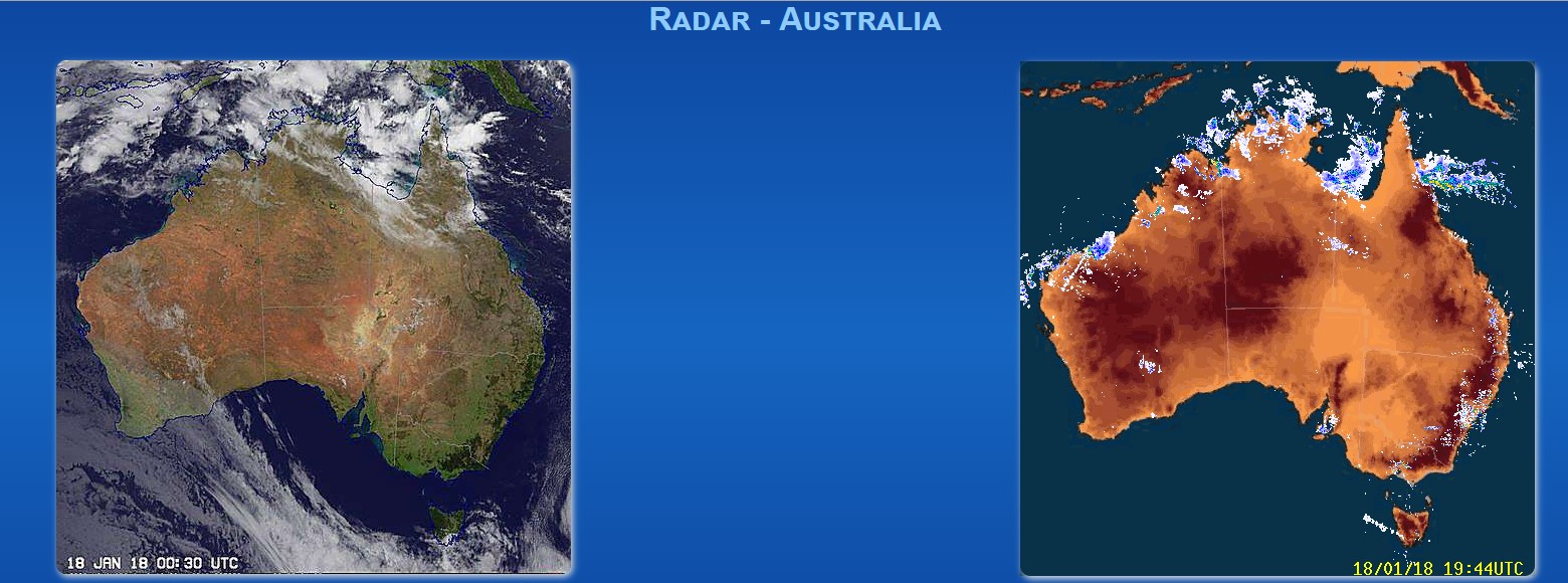

(I'm very new to Meteotemplate but I've looked around and not seen any mention of this block - please forgive any oversight on my part.)
I've loaded up the 'radarAU' (2.0) block and placed in on my home page. The left-hand side shows the satellite cloud image correctly.
However the right hand side shows the combined radar images but without a background of the land.
I do note that the PHP code for that block makes reference to "url(homepage/imgs/auRadarBG.png)" but there is no 'imgs' folder in 'homepage' - there is in the next level up but that folder does not contain the PNG file referenced; neither does the block folder itself.
Is there a file missing or in the wrong location or amy I doing something stupid?

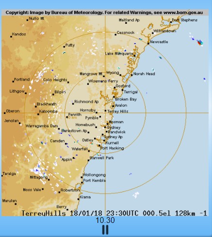

Are you speaking of the 'block' or the 'plug-in'?
This is the 'block' I use (for local weather/rain radar - radarAURegional):
The second is the 'plug-in'' which covers our little island.
Sydney Radar.jpg (58.67 KiB) Viewed 13486 times

Now you have a new user a bit confused.
I'm talking about the 2nd of the images you show. I picked up from the "Blocks" web page and I have installed it as a block on the main web site page. However you refer to that as a plug-in!
Susan
(Image taken from my desktop home screen)

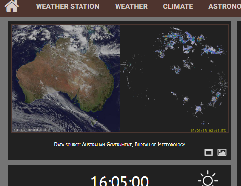

Re: Background to radarAU rain radar image missing
Post by Jachym » Fri Jan 19, 2018 7:37 am
I think I know why, I will fix it ASAP
Post by Jachym » Fri Jan 19, 2018 7:47 am
ok, fixed - Radar Australia 2.1
Post by Aussie Susan » Fri Jan 19, 2018 8:40 am
Brilliant - 2.1 works very well.

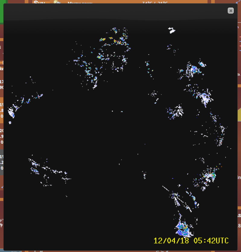

Hi
I have only recently started using meteotemplate. I am using radarAU block 2.1. When I click on the 2nd image(right one) it enlarges but the land mass is gone. Is there something extra I need to do?
Many thanks
Chris[attachment=0]radarAU 2.1.
www.tpweather.com.au/site
radarAU 2.1.PNG (90.42 KiB) Viewed 13227 times
Post by Jachym » Thu Apr 12, 2018 6:08 pm
Could be missing in the block, I will look at it over the weekend

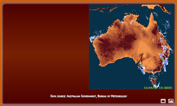

Just an update, the satellite image that is normally on the right has disappeared.

Post by John B » Sat Apr 14, 2018 12:19 am
G'day, Chris,
I suspect this is your problem. Not you, not MT and not Jáchym.
http://www.bom.gov.au/products/national ... loop.shtml

Post by tpweather » Sat Apr 14, 2018 12:50 am
Ah. Many thanks. I didn't think of that. :oops:

Post by tpweather » Sat Apr 14, 2018 11:51 pm
Recieved the update. Many thanks Jachym. :D
