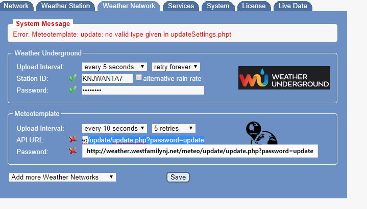

I just started up a new Meteobridge using a TP-Link MR2030 and everything went well until I tried to link it to meteotemplate. I put the address to the update.php in the field, trying both with ?password=xxx and without the password part, with the proper password in the password field. It doesn't want to work, see the screenshot below with the error message. I tried changing the database update page to say api instead of WU, and that does not seem to help. Anyone have any ideas?

In API URL place the exact path to your template file api.php (including the file name api.php at the end). In the Password field enter your update password.

Thanks, but from the screenshot you can see that I did that.

MJW wrote: Tue Jan 30, 2018 1:29 pm Thanks, but from the screenshot you can see that I did that.
Actually, you haven't done that in the screenshot. Your URL is to the update directory. Your URL should be to the file api.php which is in the root directory of your template. It looks to me like yours would be http://weather.westfamilynj.net./meteo/api.php. Your update password goes in the password field and not at the end of the URL. Also enter just the update password not another URL in the password field.

You are both right, I didn't have the right file & location. It is working now. Looking at what api.php does, it pushes the data straight to the MySQL installation, no need to have it set up separately in the meteobridge services, correct?
