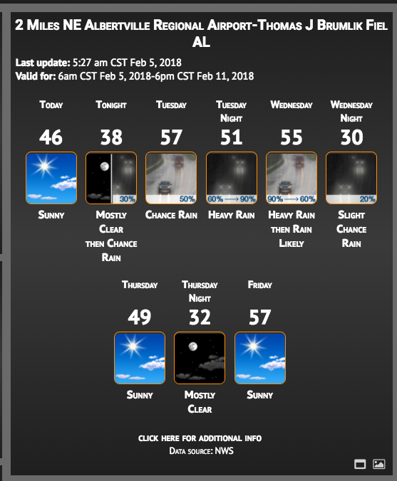

Re: nwsForecast Block Error
Post by nineback » Mon Feb 05, 2018 12:46 pm
Mine is working fine here.
Screenshot 2018-02-05 06.43.49.png (117.88 KiB) Viewed 6668 times

nineback
Posts: 74
Joined: Thu Aug 24, 2017 11:12 am
Location: Alabama
Software: WeeWX
Post by nineback » Mon Feb 05, 2018 12:53 pm
Station.
