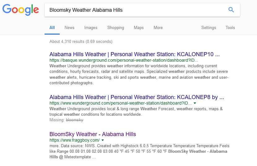

My google search (3rd one down):
Do you prohibit crawlers in your .htaccess? I currently allow all crawlers. You can ask Google to re-crawl your website (If you need to modify your .htaccess file). https://support.google.com/webmasters/a ... 5812?hl=en

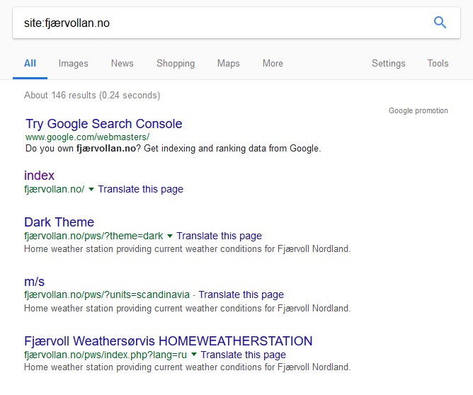

OK.. It seems your domain is hosting other information/pages, including Meteotemplate..
From the screenshot below, you can see the pages Google has crawled.
Check your Google index status: https://support.google.com/webmasters/a ... 5256?hl=en
I don't see your meteotemplate site listed, thus not crawled. You can rectify this by using this index file from the wiki.
