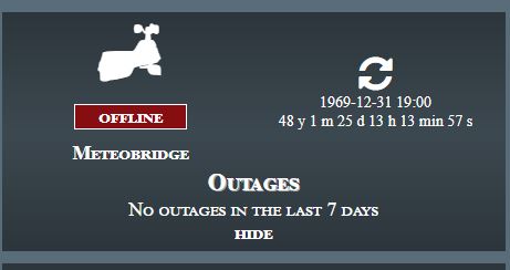

I had this error for a few hours this morning. Then it went back to normal. Notice the dates. 48 Years ago.

31/12/1969 corresponds to "null" time for computers so it was most likely an issue with the db which was not available. When the time passed to a computer is 0 it is transformed to this

Thanks Jachym!
