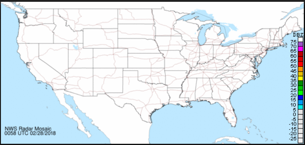

Re: US NWS Change Breaks Forecast & Discussion Blocks - Easy Fix
Post by MonyMony » Wed Feb 28, 2018 1:30 am
dmgould wrote: Wed Feb 28, 2018 12:32 am US Radar block might be the same issue. I haven't had a chance to check into it yet.
Looks like they managed to break their own site. All the radars look to be down now and I have to think it is related.

I am curious if the radars go HTTPS too.

dmgould
Posts: 173
Post by dmgould » Wed Feb 28, 2018 2:26 am
They are back up working for now. I pulled the whole US animated gif URL (http) from the block code and pasted it into my browser. It went to the blank map but showing no radar returns. When I changed it to https I got the radar returns. Now when I put in http is forwards automatically to https and shows the radar returns. Eventually I'm thinking all of the http URLs in the radar block will have to be changed to https as well. At least they made it work for now.
