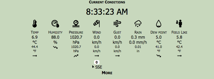

I installed the new version and activated the option to show Alternate Values.
Screen Shot 2018-02-25 at 10.11.15 AM.png (52.37 KiB) Viewed 10176 times
Unfortunately the Alternate Pressure and Wind Speed units are getting ignored.

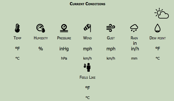

I looked at the code and the values appear to be hard coded so guessing something got missed in the update.
$alternativeW = "mph";
$alternativeP = "inhg";
Nice update and BTW, congrats on the new job Jachym!

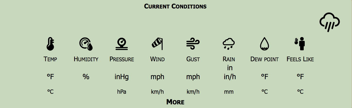

Additionally, if I update the code to set:
$alternativeP = "hpa";
or
$alternativeP = "mmhg";
Then the block completely breaks:
Screen Shot 2018-02-25 at 10.27.16 AM.png (73.93 KiB) Viewed 10175 times
Manually updating $alternateW works as expected.

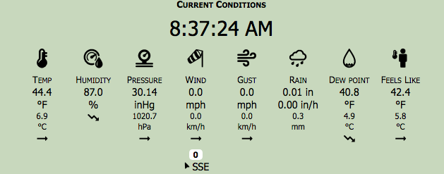

Hi Jachym,
No joy.... If I remove them then the block is blank.
Screen Shot 2018-02-26 at 7.40.43 AM.png (33.12 KiB) Viewed 10144 times
Re: Current Block (v24) - Showing incorrect Alternate Values
Post by MonyMony » Mon Feb 26, 2018 1:00 pm
Figured out the problem...
In lines 1694 thru 1764 the Eval function is missing the closing parenthesis. Once I add that then everything works. I changed it to this:

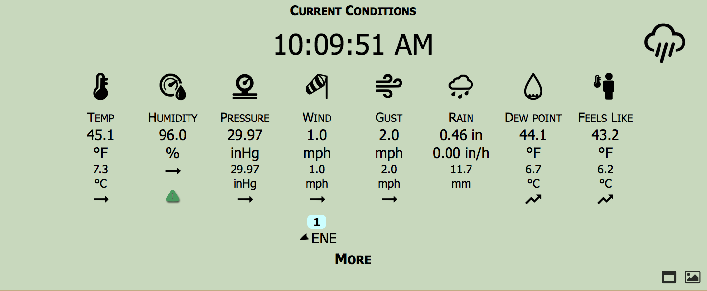

One very minor issue though...
If I change my site to Metric (normally Imperial Units), then those alternate values do not change back to their normally default units. Honestly I don't mind if this left this way as it is a low possibility that anyone would notice, but figured I would point it out just so you are aware.
Site changed to Metric:
Screen Shot 2018-02-26 at 8.34.22 AM.png (43.24 KiB) Viewed 10138 times
Site set to Default Units (Imperial)
Screen Shot 2018-02-26 at 8.38.29 AM.png (40.2 KiB) Viewed 10136 times
Thanks again for adding the Alternate Values to the CURRENT module. This is something I have been hoping to see for some time. :D
