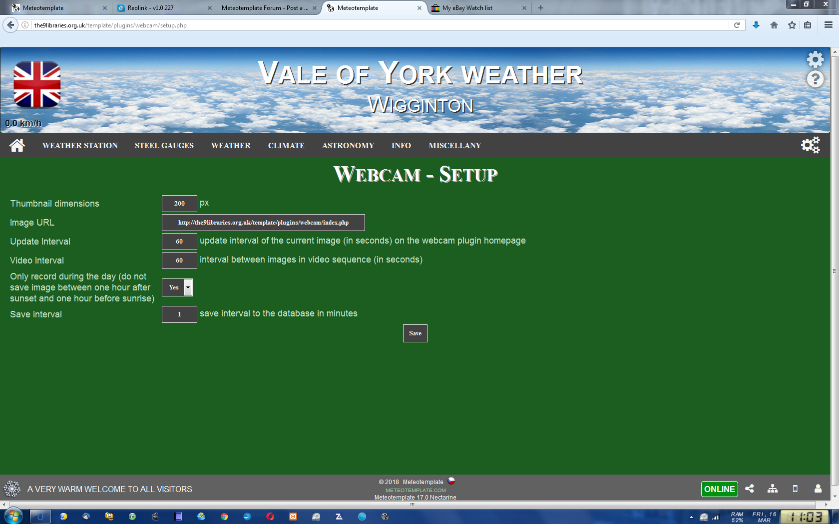

Hi Tom,
reading, with some fascination, your webcam exploits. Persistence with WU obviously does pay off in the end. I am currently awaiting approval though I guess that won't happen until I have images that they can see! However, progress is being made. The FTP problem is solved. I was hugely encouraged to think in simple terms once I saw that your web hosting experiences mirrored mine. My IT-minded son suggested the problem was SFTP v. FTP Not knowing any different I was almost minded to contact 1&1 to talk through the problem. Good job I didn't. It was merely a password problem. In my haste to set up the camera I completely overlooked the fact that the password requires at least one upper case letter. Slaps head in disbelief. Change password and "open sesame" is the result. I took on board your suggestion to upload to a CAM folder outside the template and I now have sensible images uploading at one minute intervals. Big plus. BUT....no images loading on the template as yet. I am trying to use the Reolink solely as a weathercam so I am suppressing, as far as possible, any motion detection settings. I hope that is right.
The webcam plugin setting is set thus http://the9libraries.org.uk/template/pl ... /index.php and the other settings are entered as you might see from the snapshot attached. The CRON job is working quite smoothly and seems to be perfectly as it should be. Which doesn't leave me with any other options. I have seen that others have experienced similar frustrations so I am hoping that I am missing something equally as basic as getting my password right in the first place
What do you, or perhaps others, think??

Re: Webcam Plugin - Server Space Analysis
You need to point to an image.
The big question is does your camera upload an image with the exact same name, or is there some kind of date jibberish added to the back of the file name.
You need: filename.jpg
if your camera is uploading something like filename20180316150155.jpg (or some other unique identifier) PLEASE PM me.
I can help you fix it.
I would prefer your path to the image be completely outside the template path, but this is not necessary.
Examples:
www.the9libraries.org.uk/template/plugi ... /image.jpg <-- This folder is in the template path
www.the9libraries.org.uk/webcam/image.jpg <-- This folder is not in the template path
The reason is that you may need to change permissions for the folder and I don't like messing with permission changes in the template folders.
You just need to create the folder in the root directory and not the template directory. This is only my opinion.
