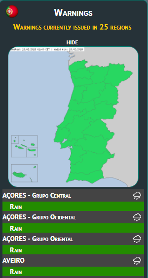

I am having the same problem for the last 3 or 4 days and it didn't correct yet. It shows warnings for all 25 regions in Portugal, and for those regions that have no current warnings (showed in green) it shows "rain warning".
Clearing cache is not solving the problem.

Post by meteocaldas » Sun Feb 18, 2018 1:38 am
Hi Jachym,
Almost one month later, WarningsEuRegions is still not working correctly.
It always shows warnings for all regions and when there is no warnings (green) it displays a rain warning
I tried to solve this issue but my knowledge is too short to understand how you parsed their data... :-)
Could you please take a quick look and see if their XML feed has changed and if the former way of parsing their data is still correct?
Thank you soooooooo much!

Re: warningsEUregions data incorrect
Post by Jachym » Sat Apr 28, 2018 5:56 am
Fixed

meteocaldas
Posts: 111
Station model: OS WMR-88A
Post by meteocaldas » Mon May 07, 2018 12:57 am
Thank you soooo much, Jachym!
It is working like a charm :-)
