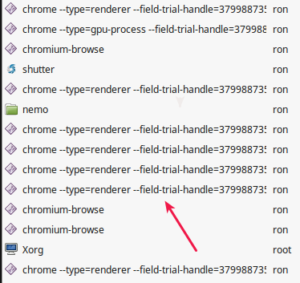

I'm not the sharpest knife in the drawer (as they say) but this happened to me some months ago, right after I joined and installed MT."Aw snap" and gauges not loading. Also some graphs would not load. I searched everywhere on the Internet looking for the issue. I tried all the solutions I could find. It finally stabilized to the point where everything works (after several updates from Google), but my steel gauges.
I came across a thread, but didn't save the link, where some were discussing "field trials". I don't want to sound like a conspiracy nutjob, but they said that Google tends to "try out" various new components, or tweaks to the browser, on random people. They said to check the system monitor for items that say "field trial". Some of these tests that Google runs in the background, cause problems for different people. At least that is the theory they put forward.
I looked at that time and had 3 or 4 field trial items in the list. Then the problem eventually cleared up, the field trials were down to 1 or two, and after a couple chrome updates things were back to normal. Now things are down the drain again. 2/3 of my page items don't load for me. Apparently, (if this is the cause) it leaves something messed up, until later updates clear it. But that wouldn't explain why FF doesn't work either during this time would it. In the last week, I have noticed the Aw Snaps coming back on various pages. I need to reinstall Firefox and test it.
I have tried clearing Cloud Flare cache, and turning off Cloud Flare for hours, to see if it helped, nope. So Cloud Flare is back on. I restarted my server, no change.
Anyhow, for what it's worth. I just checked since my site won't hardly display items, and I have a TON of these "field trials" listed. This is just 8 that I snagged in the screen shot.
I am running Linux Mint 18.3 Using Chrome and Chromium.
Here is the link to my page, if someone knows for sure that the field trials may not have a legitimate connection, then I'll take my tinfoil hat, back in the drawer. :lol: I have no idea what the cause is, but thought I would share what I had observed. http://www.ronscountry.com/weather/temp ... esktop.php
