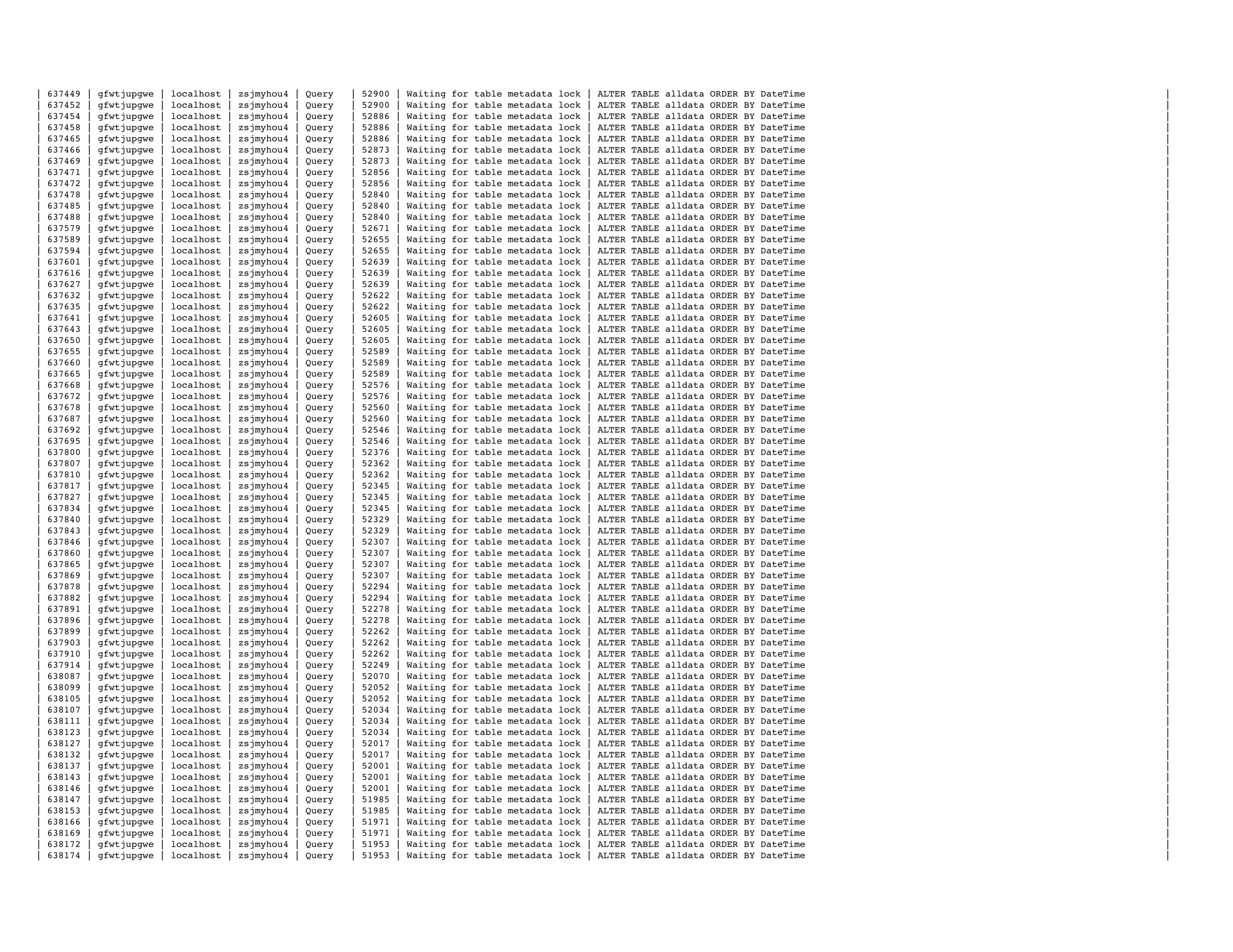

This message I got today, what can this be?
You have tried to access www.wetter-bad-sobernheim.de but the server has detected a problem with the website and denied access.
Apache/2.4.10 Server at www.wetter-bad-sobernheim.de Port 80

you need to check the server error log, because from this there is no way to tell what is wrong

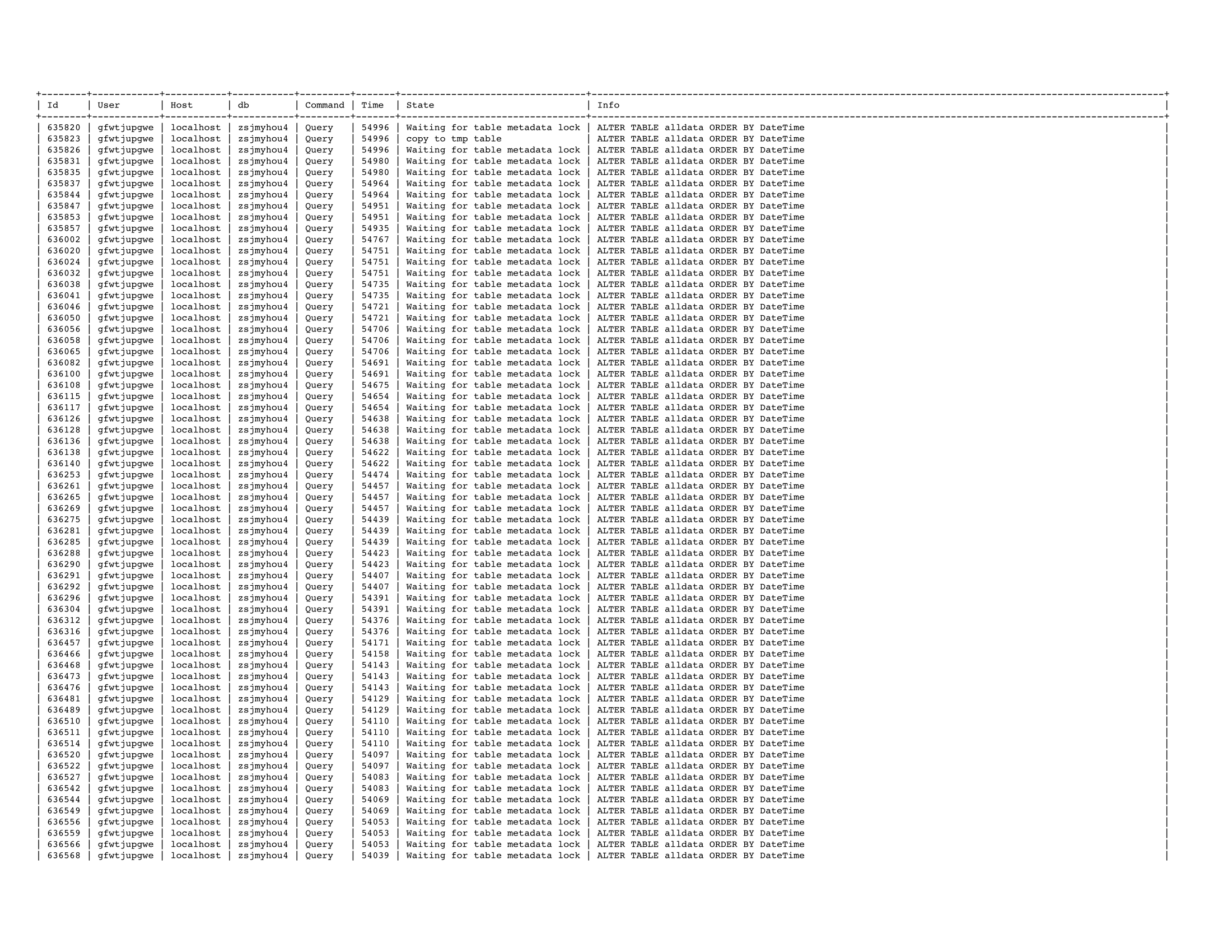

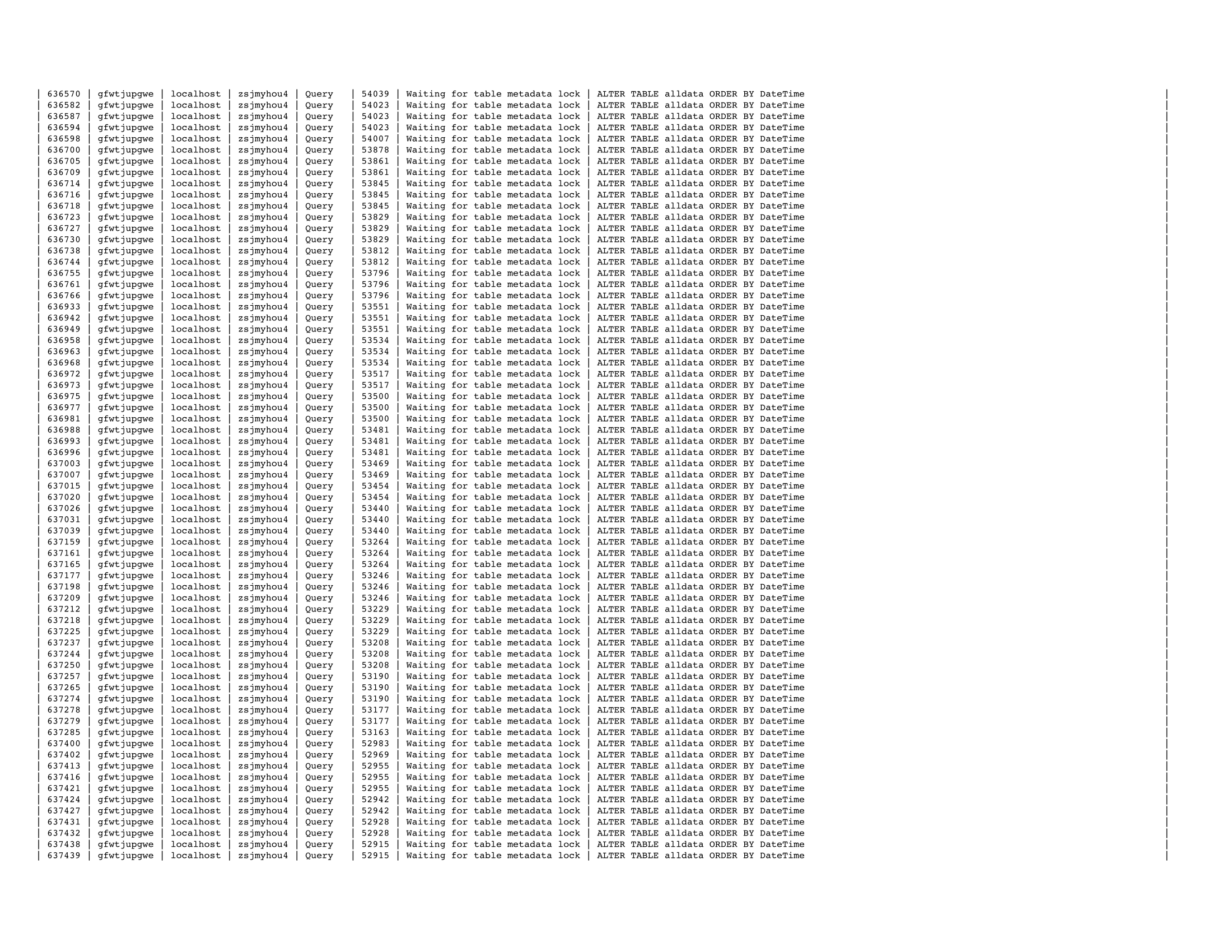

The report of the database is attached as a file
He is 30 pages long

It seems something is locking up your database..
https://stackoverflow.com/questions/131 ... ata-lock-s (This might be outdated - Depends on what version you are running.) This is a good start..
Google "Waiting for table metadata lock". Plethora of information.
