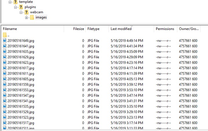

Post by Dehatter » Thu May 16, 2019 8:54 pm
So...
Any of you really smart people have a clue what is happening?
Update creates the file, but it never get filled, and since it does not contain any data, the thumbnail does not get created.
directory:
Annotation 2019-05-16 165415.jpg (104.57 KiB) Viewed 48789 times
Any and all suggestions welcome!!
Re: Webcam
Post by Dehatter » Fri May 17, 2019 2:06 pm
So...
In my case, it seems I cannot use a "secure" source for the image file.
If anyone else is having this issue, try this as a solution ... make sure your image source is http:// not https://
All is working now for me.
