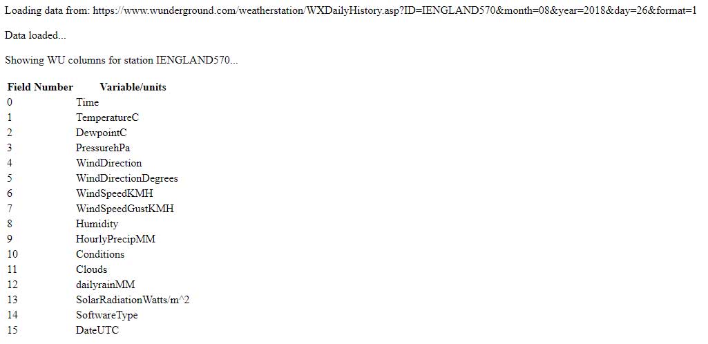

Hi there, it's quite a long time since I did this, but after entering your weather Underground ID, you then click on 'Show Field Numbers' button, you should then see the image below. Use the field numbers shown in the results in the corresponding 'Variables' boxes. Are you getting that far?
From what you're saying you're getting a list of data entries after clicking 'Show Field Numbers'?

No. I do not get that list. I only get:
Loading data from: https://www.wunderground.com/weathersta ... 5&format=1
Unable to load data from WU or incorrect WU specified.
