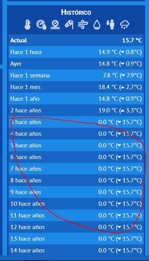

Hi there,
I recently updated to 17.1 (great update process as always) and noticed that my history block is now displaying data for a very long time range (up to 48 years):
(bottom right on https://www.elspinars.es desktop version)
I am pretty sure (but not 100%) that it was not the case before the update and that only the years for which data were available were displayed.
Anybody else is seeing something similar ?
Cheers,
Pol-Brieuc

Hello polbrieuc!
I have the same issue.
The problem is due to the fact that the first record of the alldata database has the date value "01/01/1970" (with null value ​​for the other fields ).
By deleting the record, the problem disappears.
I believe, however, that this record is created periodically for other reasons.
