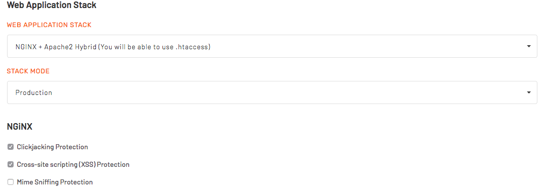

I mis-typed, it isn't a PHP setting but rather its part of cross site/cross script vulnerabilities in Apache/Nginx. It is a pretty deep rabbit hole but I use a control panel called Runcloud that manages my web server, etc hosted on a VM with Digitalocean. and it has several security settings enabled by default for every site that you create.
Greenshot 2019-01-14 17.06.38.png (40.25 KiB) Viewed 24116 times
Some very basic info on it can be purused here: https://geekflare.com/secure-mime-types ... e-options/

I looked at it quickly but can't find where the “nosniff” is inserted? In the index.html? or htaccess or is at your hosts control panel settings?

Ok I was able to locate it eventually. For my setup you see the following listed in /etc/nginx-rc/conf.d/WX.d/headers.conf the file contains the following if nosniff is enabled within Runcloud.
# Do not edit this file
# Editing this file manually might break RunCloud System
# If you think there is a bug, contact us at bug@runcloud.io
# Header option for security purpose
add_header X-Frame-Options "SAMEORIGIN";
add_header X-XSS-Protection "1; mode=block";
add_header X-Content-Type-Options "nosniff";
# HSTS
# HSTS DISABLED"
include /etc/nginx-rc/extra.d/WX.headers.*.conf;
