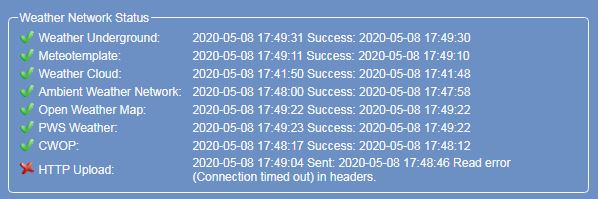

I get this all the time with my MB (not a nano). My weather data is being sent via the api.php every 30 seconds using Meteotemplate in the Weather Services tab. This error occurs every 5 minutes. The old Meteotemplate versions, before the api, used an http upload. Those http upload statements are still in my Services tab for upload every 5 minutes, but they are grayed out. Maybe it's those old upload statements causing an issue. I also run a MB Pro on another site. This does not happen on the Pro which is setup identically. It's a mystery for me too.
