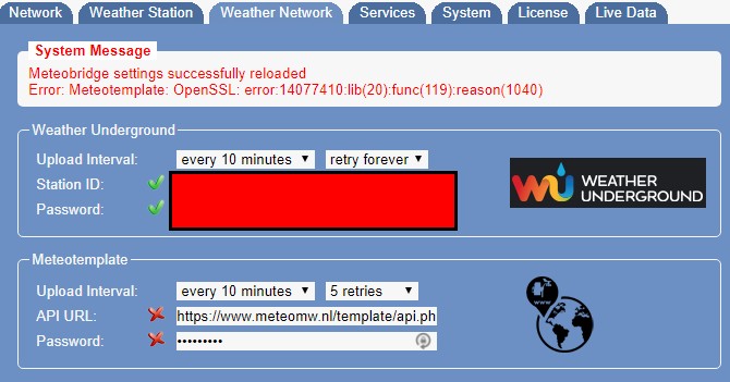

That is what I did but it do not work. I got the following message:
Error: Meteotemplate: https://www.meteomw.nl/template/api.php ... 9&PASS=<my password>: HTTPS support not compiled in.

I got also the error messages:
1) Error: Meteotemplate: OpenSSL: error:14077410:lib(20):func(119):reason(1040)
2)error:14077410:lib(20):func(119):reason(1040) Unable to establish SSL connection. (5 more tries, next in 5 secs)
On advice of Smarbedded (supplier meteobridge) changed http to https.

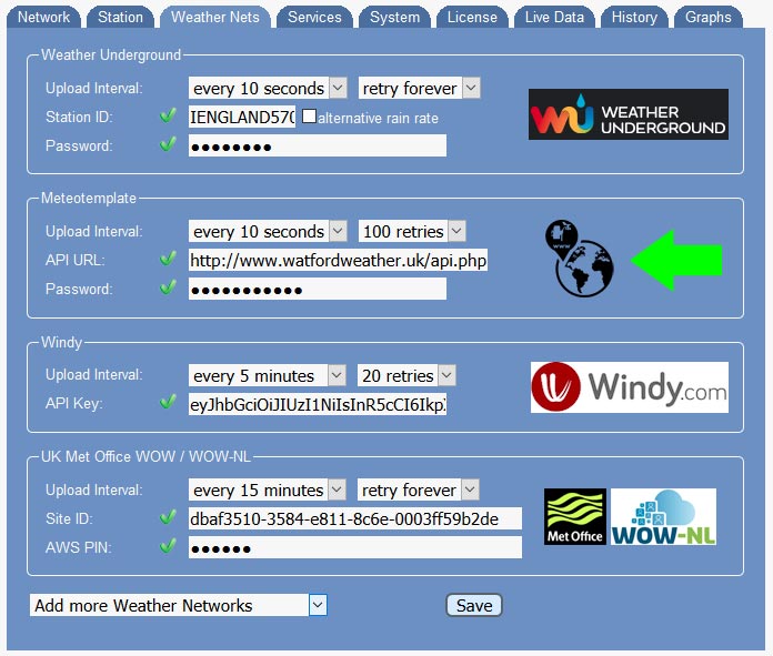

Post by Johnny » Tue Aug 20, 2019 8:43 pm
Hi Meteomw, for what it's worth the image below is how mine is set up, sounds like and http or https issue, maybe someone else on the forum can point you in the right direction.

Thx Johnny, I have the same set-up only with my credentials and I also tried http and https. Nöt ing helps. Could it be a server problem?

Post by meteomw » Wed Aug 21, 2019 5:58 am
I have added two screenshots, perhaps that gives more clarity about the problem. I have also been in contact with Smartbedded and they indicate that it is probably a problem at / home / openssl / wget-ssl, but the webhoster indicates that this directory does not exist. Does anyone know what's going on?
