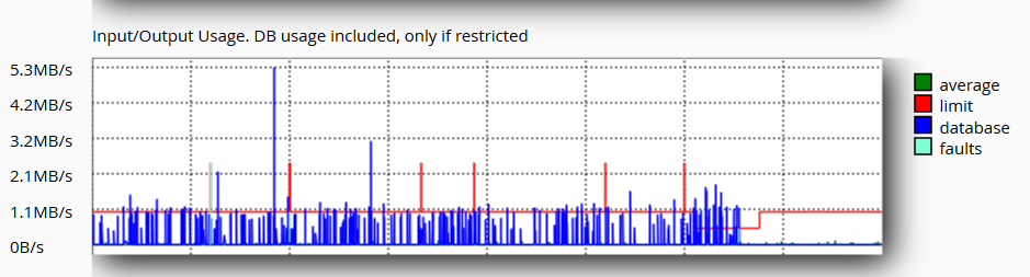

Attached is the snapshot of the DB I/O for the last 30 days. The dramatic drop in I/O is where I edited the api.php file.
Your thoughts?
I am using v17.1 of MT, api.php v3.1.
Your thoughts?

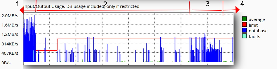

Hey Jachym,
Here is the evidence that there is a problem with line 1482 ("ALTER TABLES...") in api.php that isn't executing as you expect.
The snapshot of the last 7 days of the db I/O is instructive:
Section 1 is where the 2 api.php files (for both websites) is unmodified from the 17.1 update.
Section 2 is when the files are commented out at line 1482
Section 3 is when 1 of the 2 api.php files is commented, the other is uncommented. Both are saved with Unix EOL.
Section 4 is where both have line 1482 commented. Identical to Section 2.
So it looks like the ALTER TABLES sql command is still executed every 5 minutes.
Jim
Jim

this is something I fixed (or at least thought I did) in v 17.0. However, I just realized this command is executed at two places in the code and I only fixed one. This will be changed in v17.3.
I do not recommend deleting the line completely, there is a very important reason for having it, however it does not have to be executed every db update, but only at longer intervals.
